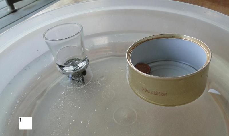

Some pictures also showing that. First picture is a tin can with a coin over to one side. Second picture is the same can and coin but the water from the shot glass was added to the tin can. The water added is just a small portion of the volume but it really makes the tin can list..
The boat I had this happen with is a C15. If I have a mast tip float, water wont get inside the hull when I dump it (which I did once last season and twice the season before). I had the "fun" water in the hull experiment (which required a rescue from a power boat) before I added the mast tip float.

Very interesting thread. It never would have occurred to me to test the water ballast theory with a can and a quarter. I guess that's why we pay Walt the big bucks. Thanks!

Take the quarter out and the can may right. It would if the bottom weren't flat anyway.
If we learn nothing from this, don't pour a bunch of lead pellets into your ballast tank (Or a bunch of quarters).
