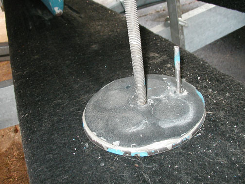

The tank definitly overflows when you have four or more people and all their gear on board and the water line rises and inch or two above the empty boat level. Last weekend I took on 20 gallons of water before the bilge pump started up and kept the level down, and this was tied up to the dock at night. If you get water leaking out the top of the tank, as I have, there are problems at both ends of the tank. My lower valve (see picture) has dried harden resin coating much of the gasket, and the top valve has raised drops of hard resin keeping the washer from sealing. Someone at Hunter quality control was asleep when my boat went through check out. I plan to do the loading ramp trik to drop the lower valve. When I get the valve just off the trailer end I will have the wife unscrew the top nut and then push a cork into the open hole. That should keep extra water from entering the tank at the bottom. I will then retrailer the boat and pull it back home until I can replace the gasket. I'll do the reverse after the repairs. Question: what kind of gasket material should I use? The current stuff is a black rubbery 1/8" thick stuff. Aside from the resin coating on the gasket, it is missing parts around the edges. The boat bottom in the valve area is also very rough and needs sanding/smoothing. The other problem I have is that when water gets into the small area between the cabin sole and the tank top it migrates into the lockers under the seats, under the galley and under the head cabinet. It is flowing through thin places in the glass/resin filler between the sole and tank top. I can sit and watch it seep through small holes. What can I "paint" on this area to seal the lockers from the bilge? The glass has been overpainted with the eggshell white (paint?) that covers the locker interiors. All suggeations are appreciated.

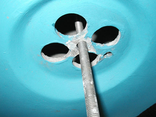

Other side of the valve
This is a picture of the boat side of the fill valve. It needs to be smooth also to make a good seal. You can see mine is quite rough. A water ballast system will only work if the water is completely trapped inside the tank. When the boat is heeled the water is lifted above the external water line and provides downward pressure or righting moment. That water will also try to flow out of the tank at both the top and bottom valves, causing loss of balast and loss of stability. It is very important to have a good seal. I'll post a picture/project here when I finish the new gaskets. Brigg

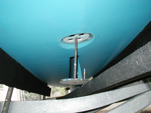

Pulled the plug
An update on pulling the ballast plug. I took Jeff's idea to move the trailer keel board and was able to drop the ballast tank plug with little trouble and on dry land. I noticed that there are only three bolts holding the long keel board in place. Also, the keel only rests in one spot, on the front lower edge, on the board. So, I took out the bolts and pivited the board under the keel, until the plug dropped off the edge (see photo). I'm playing with the idea of adding a layer of silicone latex sealer to the top of the existing gasket to build it up an 1/8th inch or so. I'll use the kind that stays flexible. If it doesn't work I can still replace the gasket. I also noticed that the circular metal plate, on my plug, is not at right angles to the long threaded rod welded into it's center. The port side of the plate, away from the guide rod, doesn't quite touch the hull while the starboard side is tightly compressed. If you look closely at the previous picture of the plug you can notice the difference in the gasket. I figured this out when I closed the plug tight and started adding water into the tank through the top vent hole using a hose. The water trickled out the port side of the plug. This should be a good way to test your seal if your boat is on the trailer. I haven't figured out a good way to square the plate so I'll just build up the gasket on the port side. I'll add all the pictures to my sailing web site and the projects page here. Brigg
