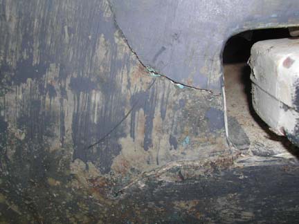

We have repaired the last 2 seasons two cracks that spread out in a "Y" about 2 inches from the front centerboard well on our '94 Hunter 26 (one of the early productions - Hull #17) . When we began to prepare the boat for VC 17, we noticed the cracks and water was dripping from one of these cracks (the tank was emptied last fall). I'm assuming that this "crack" has now expanded into the water ballast and there was some remaining water from last season. Has this been a problem with other Hunters ... cracks around the front centerboard well. I'm assuming due to the boat's design, it is subject to stress in this area. We have been very diligent in not quickly dropping the centerboard once we saw the first crack. But another appeared last season. What other damage might be going on due to these cracks? And what can be done to repair it? How serious is the problem? Is it okay to sail like this until repair can be made?
