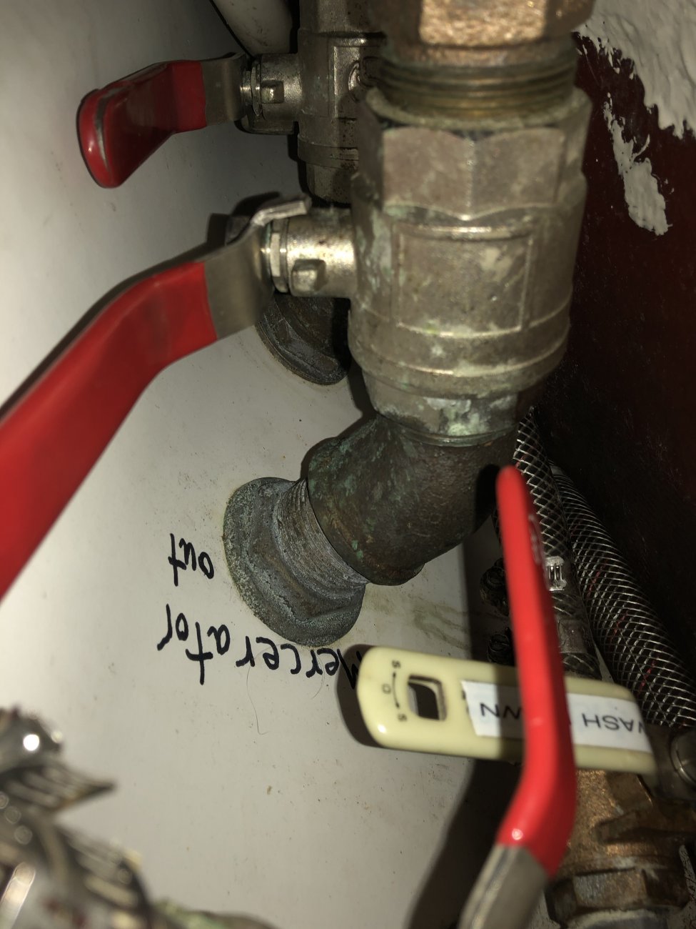

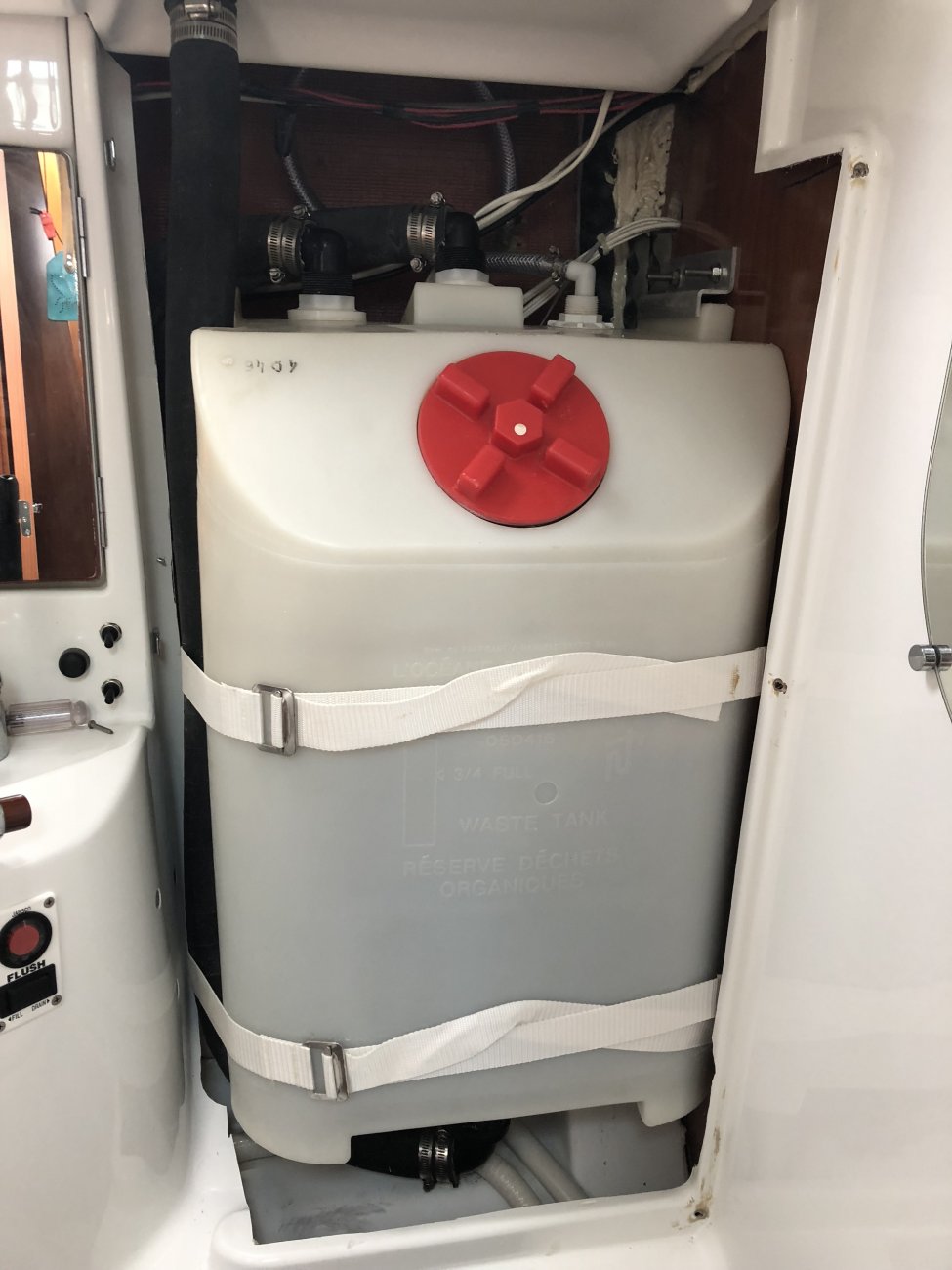

I hope you take pictures. I bought a diaphragm pump to replace a failed macerator but it's too big to fit in the forward head. I've had the bulkhead off my aft head but really didn't scrutinize the set up. I'm sure it's the same as your picture. Looks like there is a 90° fitting at the bottom which in my Pullman berth would make sense as it goes to a port thru hull. Are you planning on using one of the existing thru hulls? Wouldn't the section of hose below the waterline always be filled with effluence? I'm thinking of doing a similar set up so I'll be following this thread. I don't know how you can put a ball valve at the bottom and have any kind of easy access.

Once I remove all the ancillary hoses associated with the Macerator I will be able to reach through the cabinet to the bottom of the tank to operate a valve..... I like the idea of an inline valve at the bottom of the tank. I will snap some pictures..... I have the tank out and in my back yard now..... nice and clean! I am also taking the opportunity to replace all thru hull valves and skin fittings..... Beneteau used brass and no backing plates. Very tight fit! I will be removing the macerator valve as part of this also.

You have such nice clean bilges! Those are bronze thru hulls, the valve is brass with zinc plate. Great news on euro-thru hulls, GROCO is now making BSPP threaded fittings which are compatible with the bronze fitting straight thread. GROCO valves are a big improvement, stronger, bronze, no hollow balls, etc.
You DO have backing plates, you may not think they are robust enough but the fitting is backed. Hard to justify more robust construction in a protected area like that. Isn’t like something heavy is going to sheer it off.

Yes the area under sink is well protected..... will be hard to work in there but I will manage....... Thanks.... I love a clean dry bilge... makes for a sweet smelling boat.
