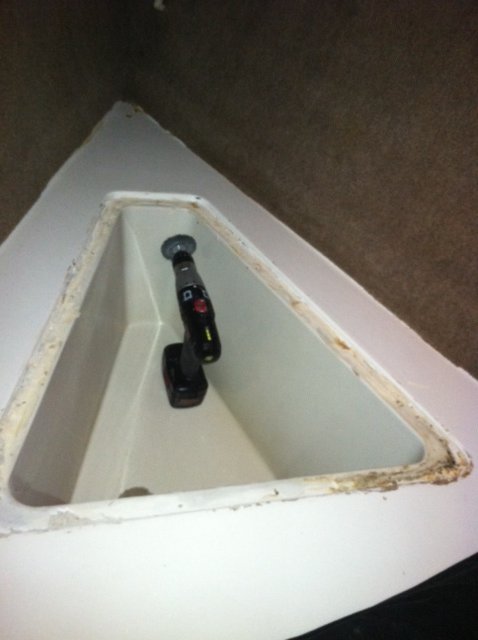

The pain is felt here as well....My husband and I have an 87 Hunter 31 and went through almost a whole summer of smelling odor coming from the holding tank under the v birth and hoses. We replaced all the hoses and things improved dramatically. We also pump and flush flush flush often. We also use KO as a chemical and NO bleach or other chemicals and flush with fresh water only. (yeah, we're trying everything) One suggestion is to take the sink right out of the head....it gives you a bit more space to work the hoses when removing them and it's not difficult to remove (at least ours wasn't). It's much easier than reaching through the cabinet door.
Our latest project involves lifting the cover (very very carefully) off the holding tank. We cut a hole in the cover, installed a deck plate and we will fiberglass the cover back into place once the weather gets warmer to prevent future leaks. The deck plate will be helpful to rinse the holding tank when necessary (and often ;) ). We're also doing the same thing on the fresh water tank under the birth in the cockpit area since that was leaking. I'm hoping for a sweet smelling boat this summer and no more leaks. I had read of someone glassing in the tank covers on this site somewhere after failed attempts to reseal them. That's where we got the idea. I posted a picture of the holding tank without the cover for you in case you want to know what the interior looks like. We flushed it out with lots of laundry soap which we learned from the "head mistress" before opening the cover. :) and it came out pretty clean (thank goodness!)
