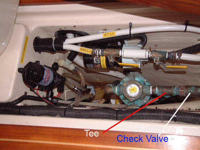

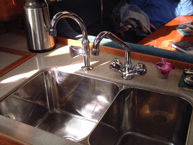

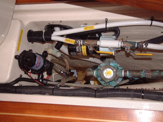

I'm going to install a wash down pump and a manual seawater pump on 04 Hunter 386. I am planning tie into the Galley Drain seacock and pipe to a Tsplitter. Now, this Seacock functions as an outlet, but 3 credibale sources and I agree that this can also function as and intake without any problems or safety issues. One side of the T splitter will go to a foot pump through a shut-off valve to carry water to the Galley sink . The other side will feed through a strainer to the wash down pump. From the pump I will split and run a water line fore to anchor locker and aft to the swim transom. The pump rated @ 7gpm. Anyone had any experience/recommendations with such an installation?
