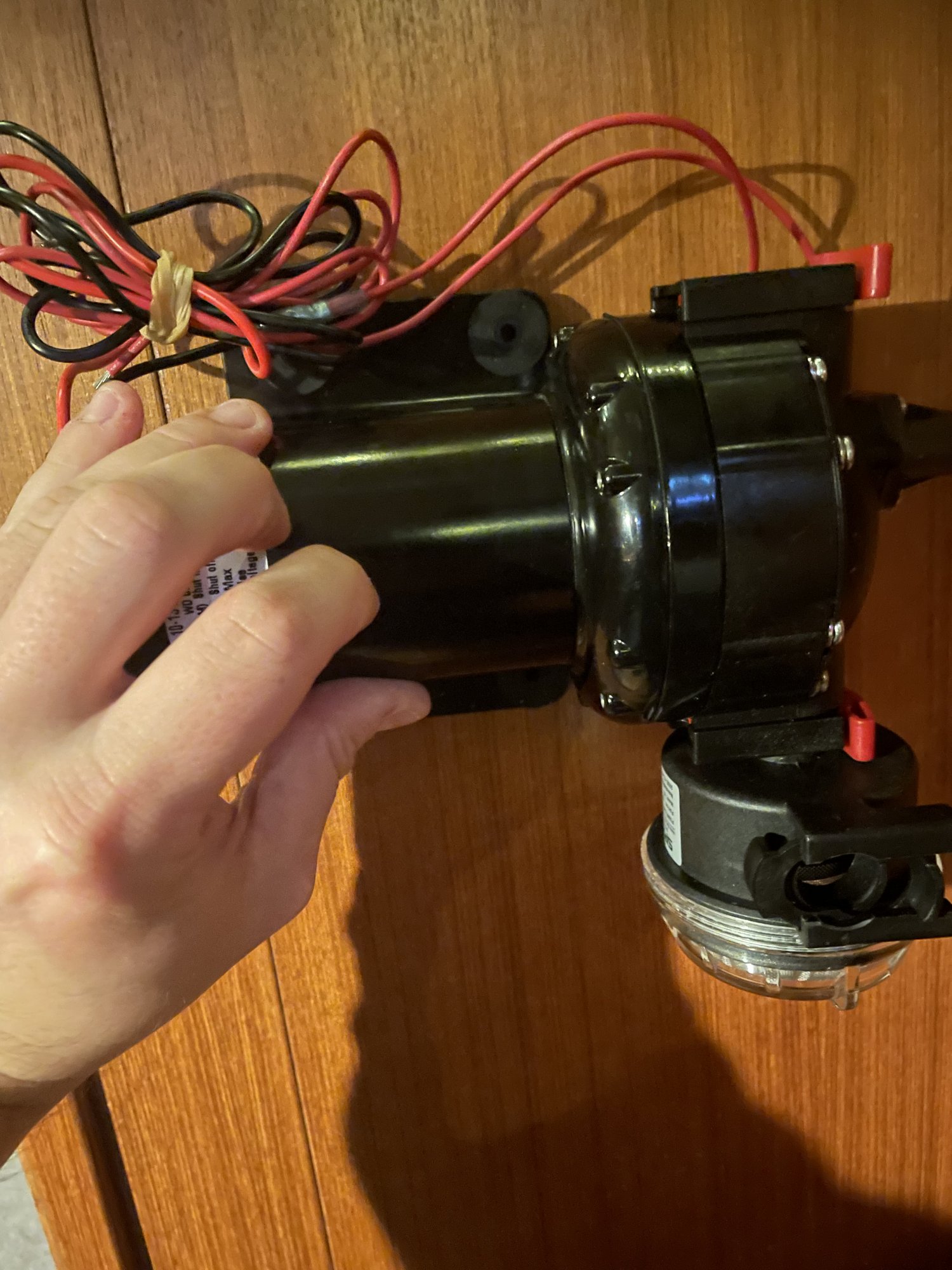

I’m planning on installing the Johnson 5.2GPM washdown pump in my anchor locker on my H460. I was wondering if I could mount it sideways on the bulkhead as in the photo below. Can the input be facedown and output face up or opposite?
(I’m not actually mounting it in the location in the photo. It’s just for illustrative purposes). Does it have to be horizontal feet down? The manual doesn’t say.

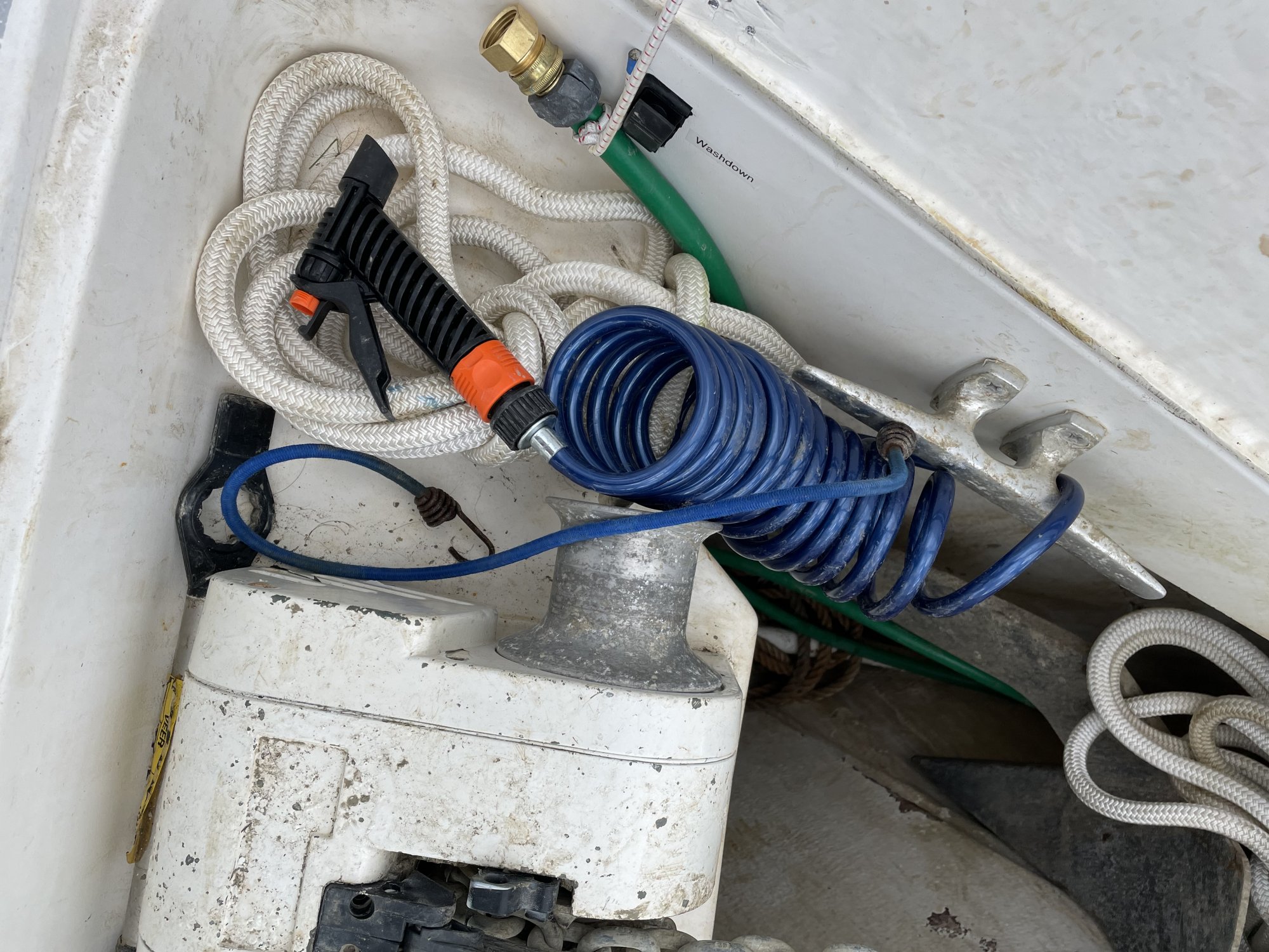

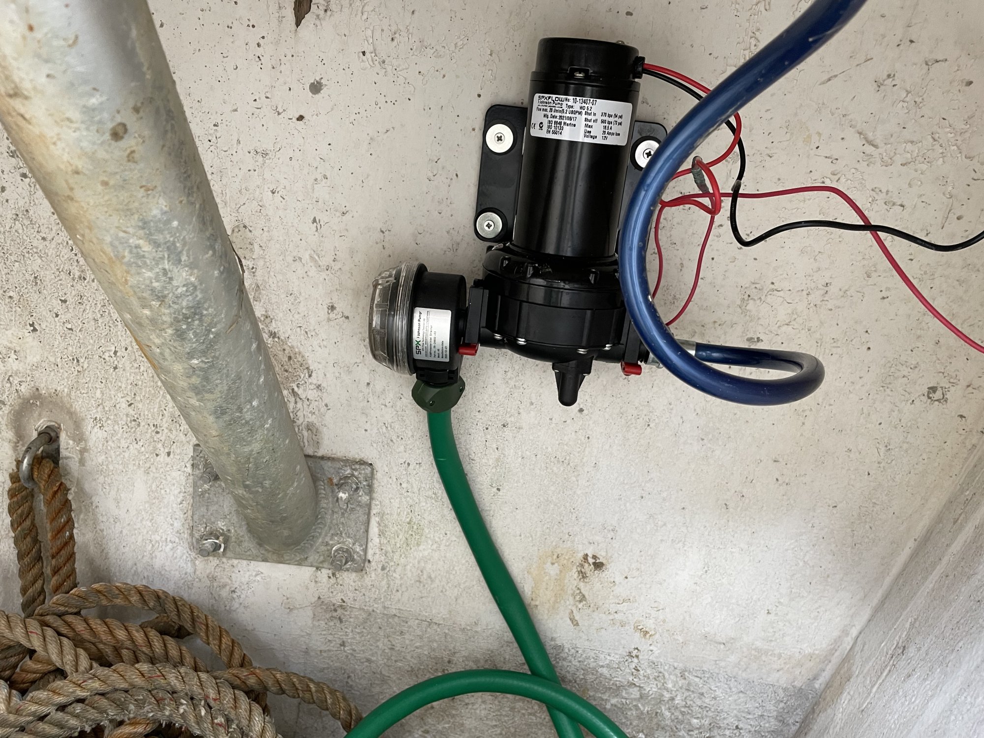

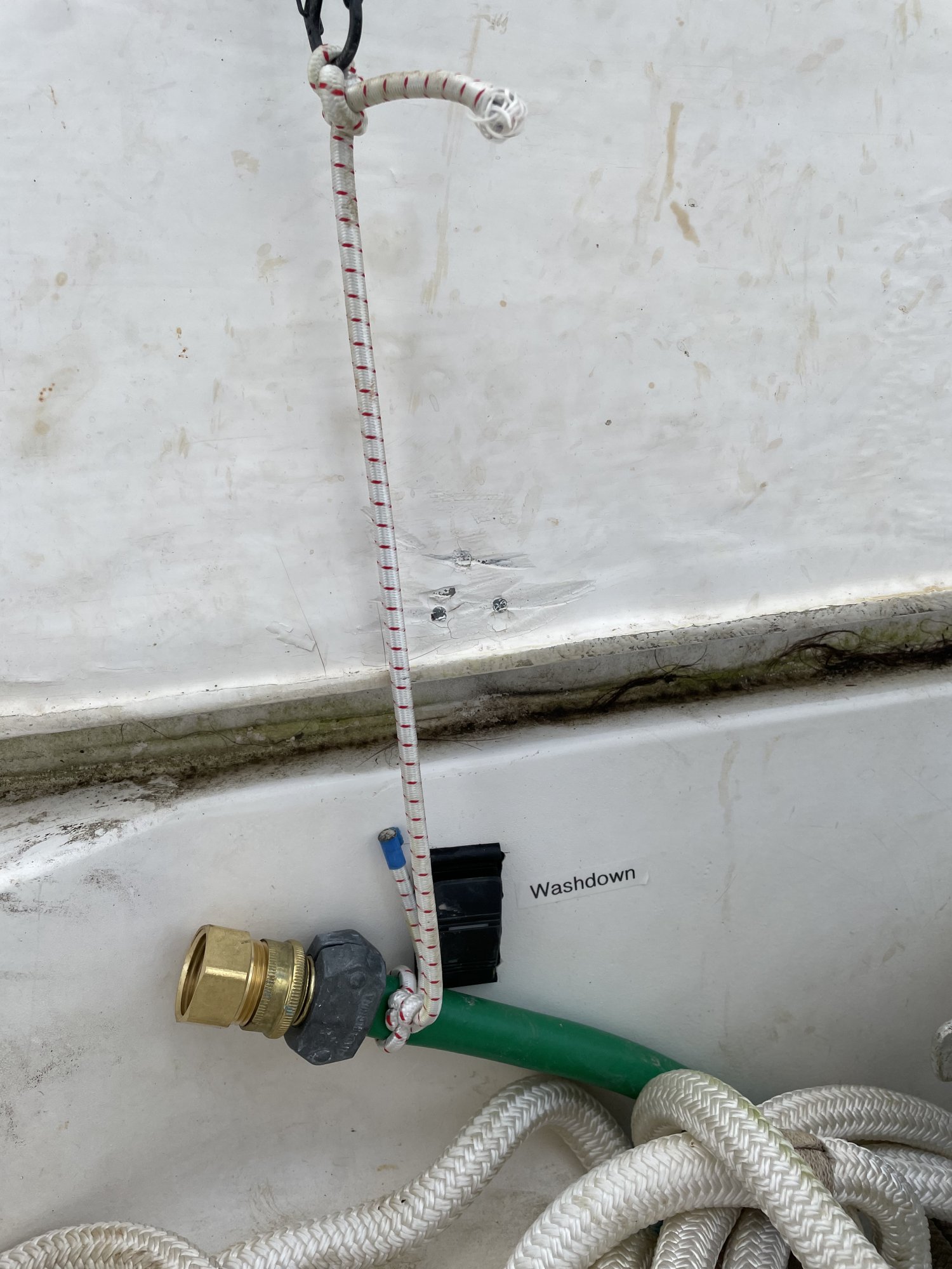

Great question. After much planning and deliberation, I decided not to use a thruhull. Originally I wanted to Tee into the forward head sink drain as I’ve seen others have done, but I wanted a pump that could be used for other things. For example, bailing out the dinghy, used for freshwater, emergency bilge. So what I did was wired the pump in the anchor locker with a switch. Then took an 8ft 5/8 garden hose and attached it to intake. That hose gets thrown overboard when I want to use the pump. It’s always attached via carabiner to the hatch door, so the end doesn’t get lose. I added some extra nuts/weight on the end to keep it underwater. I can also use that hose in a bucket of freshwater OR stick it in the dinghy. Multiple options! Everything is coiled and out of the way in the anchor locker. Here are a few pics. The green hose is the intake. Let me know if you have more questions or want more pics!
