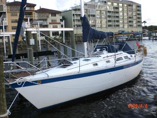

Hello All.... I'm looking for help, suggestions and/or interest in my possible quest to find a 4'3" keel for my (recently aquired) '83 "Hunter 34". The boat currently has a 5'6" draft keel that is great for deeper water sailing but I would like to take it to the Bay side of the Keys and would like to have a shallower draft..........(I've been told they can be switched to a like boat).
Anyone?
