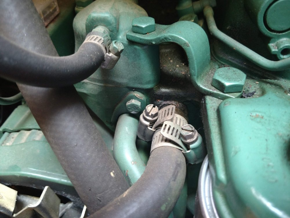

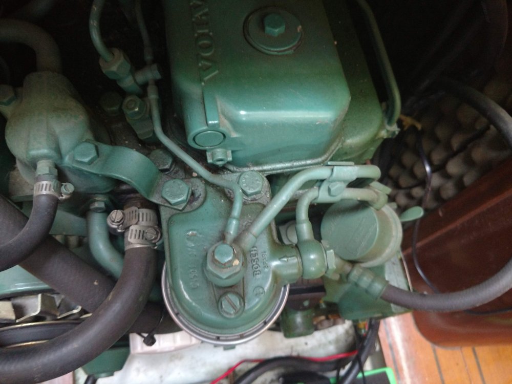

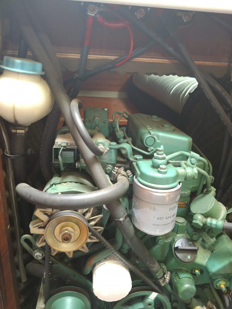

Wanting to replace the anode (zinc) in my First 310's Volvo Penta 2002 engine. I am presuming that it has never been replaced - boat has always been fresh water. I have the parts explosion of the cylinder head from VP Parts Express and it appears that the anode is supposed to be on the front of the engine under or near where the thermostat goes. But, before I order parts, I wanted to pull the old one and see what condition it was in and what kind of cap holds it in place (male vs female) and whether I need to get a new cap as well as the anode. So, I went out to the boat last night to look for it and can not find it. Does anyone know where this thing is located?

Figured it out - This model engine does not have an anode - it's the "Freshwater" cooled (antifreeze) version of the 2002B not the "Seawater cooled" - Raw water" version. Mystery solved. Good news is that is one less maintenance item to deal with!
