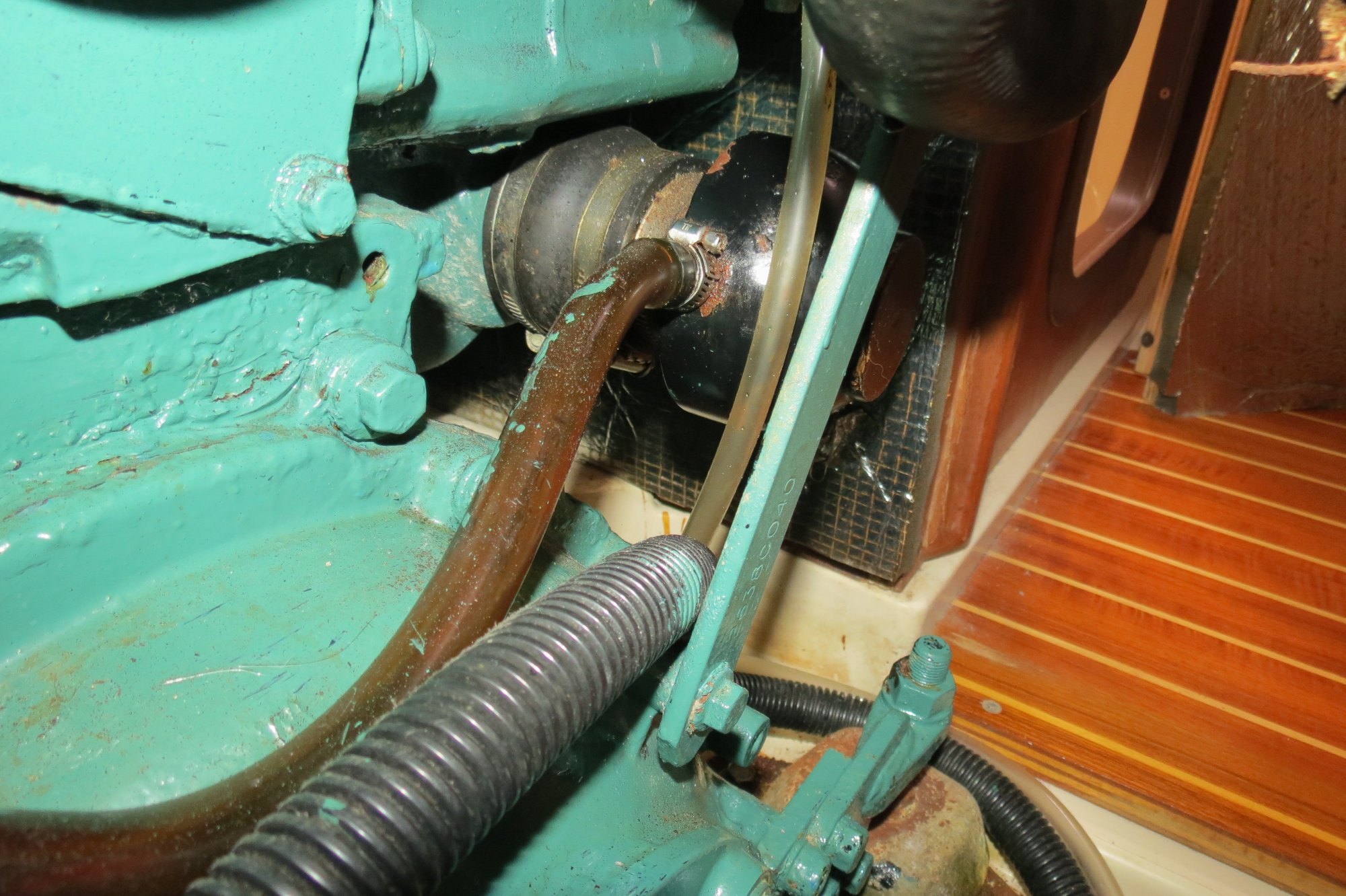

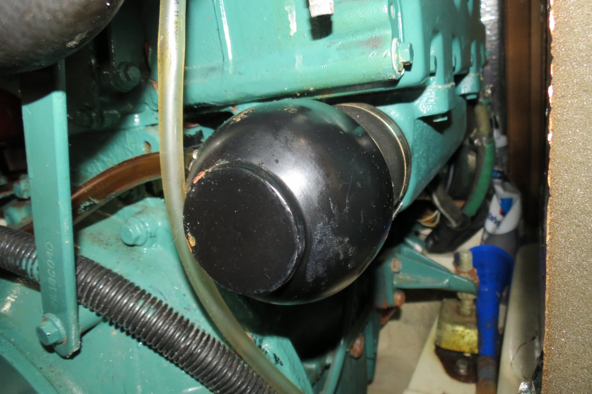

I have found that a small pool of diesel (maybe 1/8-1/4 oz) is first collecting under the air intake. The edge of the bell housing is directly under the this air intake. Of course then it migrates to other spots under the engine. There is a hose that connects to what looks like a crankcase PVC device to the air intake.
So my question to all you gearheads here-
Why would fuel be dripping out of the air intake? And if the source is the PVC connection, why would there be fuel vapor in the crankcase? And even if there was fuel coming out of the crankcase, why wouldn't it be sucked into the engine intake and be burned?
This leak under the engine only seems to occur after the engine has been stopped.
Here are pictures of the air intake and the hose that connects to the PVC device.

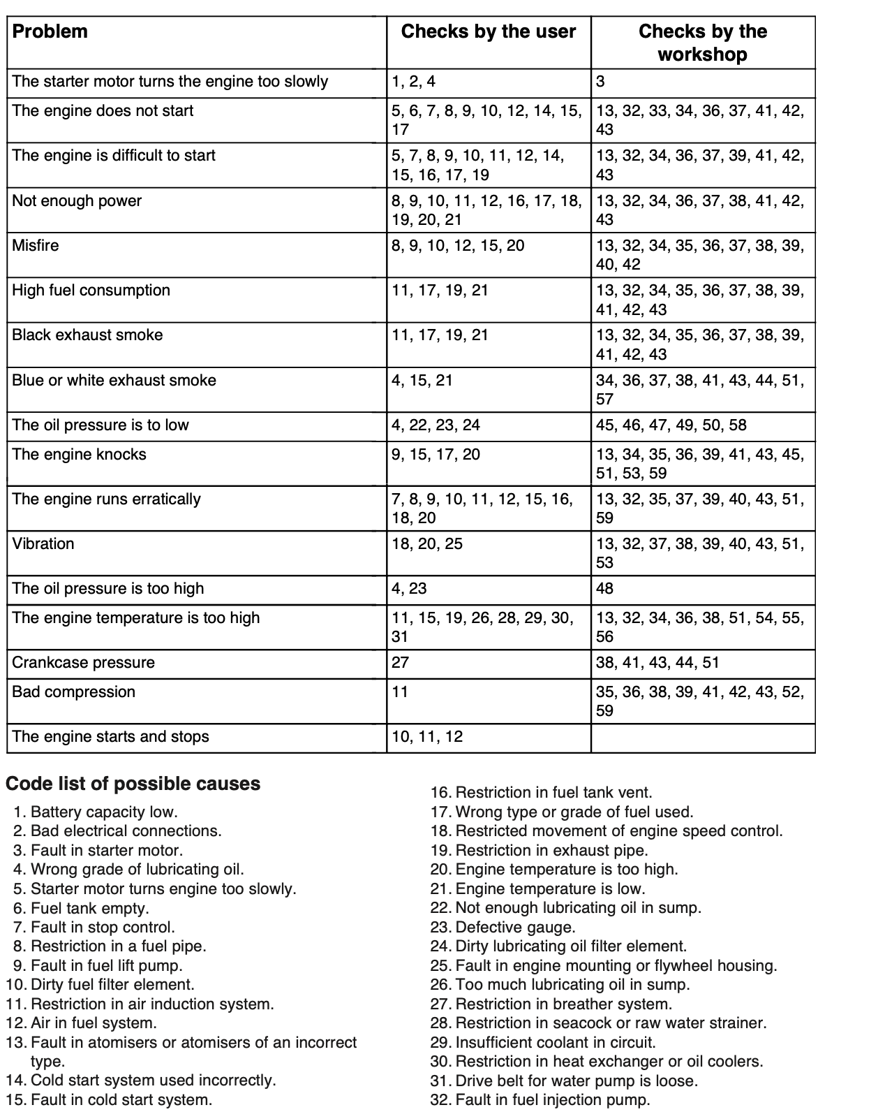

Here is my MD22L-A trouble shooting guide that may help.
Jim...

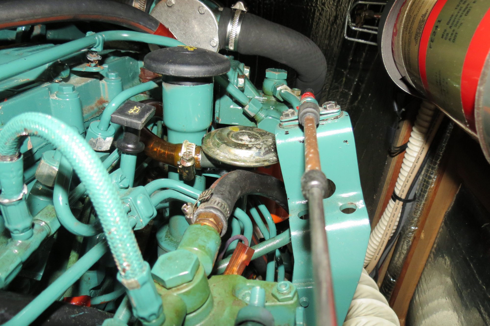

Last night I checked the return lines from the injectors based upon info I found on the web. The Banjo bolt was wet on 1,2,3 cylinders. #4 is hard to get to so I'm not sure of that one. So I pushed tissues around each of the return connections after drying off the banjos as best I could.
This morning I found the tissues on #1-3 to be damp and #4 damp too, but less so. I also found a small pool under the bell housing and a pool under the air intake. I think that the original source is the bell housing and the other spots are just where the fuel runs and settles after dripping off the bell housing.
So I am now thinking that the source are the return lines. Others on the net have found that to be the source of their leak. I still can't figure out how fuel gets to the bell housing, regardless of the original source. I can't find a path.

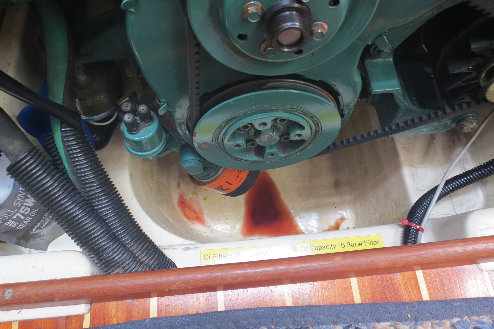

UPDATE AGAIN:

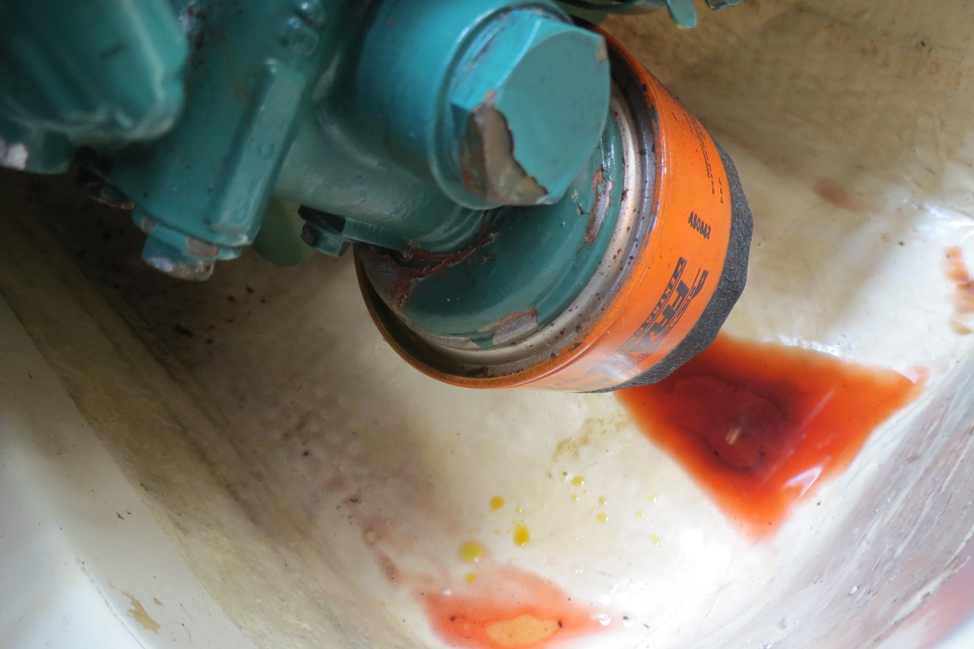

After sitting on a mooring for 3 days with no engine running, I found a pool of fuel under the front of the engine (I will guess about 1/2 oz) and smaller pools at the aft end. The oil filter at the front felt like it was damp with fuel. The injector return lines banjo were damp, and the bottom of the bell housing was very wet with fuel. Still I cannot find a source or a path.
I am ordering a set of copper washers from Parts4Engines in the UK and I may order a fuel pump just for the hell of it.
I guess I will just keep mopping up the fuel until somehow the source of the leak is revealed to me.

Feb 10, 2004
4,186
Hunter 40.5 Warwick, RI
In terms of size for a fuel leak, that's huge :yikes: !
The leak appears to be continuous. The picture is after 3 days. Its much less after 1 day.
Maybe wrap every possible leak source with TP and check frequently to see who gets damp first ? Desperate times call for desperate measures.
I have wrapped the secondary filter and found it bone dry after a couple days. I have touched every pipe and hose connection and have detected no dampness except the fuel return lines on the injectors. I have put TP around the fuel return connections and found the tissue just barely damp- not dripping and not saturated.
The only spot where there are actual drips and a great deal of wetness is at the bottom edge of the bell housing. But I can't find a path.....
