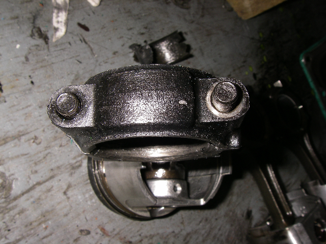

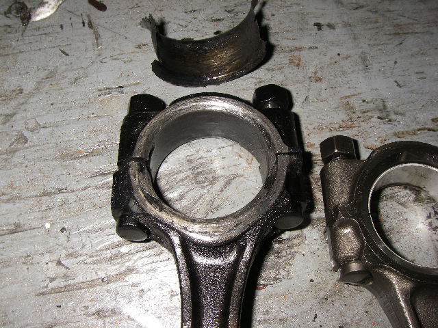

"Bottom end of failed connecting rod and bearing shows evidence of mechanical deformation and grinding due to pounding of the connecting rod on the crankshaft during operation. The bearing land on the connecting rod is not blued from extreme heat, which would have occurred had the bearing been starved of oil. The connecting rod did heat up as a consequence of pounding and failure of the hydrodynamic oil film, which resulted in lubricating oil 'cooking' onto the external surfaces causing the discoloration. The other rods and bearings show no evidence of oil starvation. The mechanic who disassembled the engine reported that he inspected the main bearings and found them to be undamaged.
The bearing cap shows evidence that the nut on the left was loose and came adrift prior to the failure as lubricating oil has cooked onto the surface where the nut would contact the bearing cap. The nut on the right side remained securely in place as the contact surface is clean. When the nut loosened, the normal bearing shape and clearance was disrupted causing failure of the oil film resulting in metal to metal contact. Once again, no bluing of the clean surface is evident.

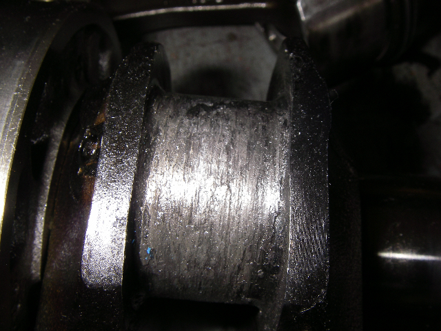

The crankpin for #1 cylinder shows evidence of galling whereby metal to metal contact between the bearing and pin occurred as a result of the hydrodynamic oil film failing due to the bearing cap loosening. The crankshaft shows no bluing.
In my opinion, the engine failure is consistent with loosening of the connecting rod nut as demonstrated above."
Both the mechanic and the insurance technical expert agree that the cause of failure is that one of the nuts on the connecting rod for cylinder #1 came off which resulted in the engine failure. They both feel that this is the result of faulty workmanship or improper torquing of the nut during engine assembly.

The other rod bearings and connecting rods (except cylinder #1), as a matter of fact all other bearings, are in great condition, and Volvo has been told this to no avail.
