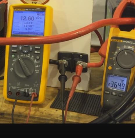

I had been meaning to put this together for a while and assembled a system for a training class I was doing. Once that was assembled I realized I could simply add a starter motor, an oscilloscope and a Fluke 289 & Fluke 376 and then would would was able to create a video on voltage transients.
In the video I’m walking through the very typical, though not necessarily ideal, marine battery system which utilizes the venerable 1, BOTH, 2, OFF battery switch. The typical 1, BOTH, 2, OFF switch is configured for both bank charge selection and bank use selection.

All I have ever measured is starters, windlasses, winches, fridge clutches etc. under load. This was the first time I bolted a starter to the bench unloaded. It was interesting to see the in-rush not change at all (in-rush happens before the engine has begun to turn) and the unloaded average current draw of 100A on a .8kW starter.
I've not noted transients any differently on boats while actually starting an engine and releasing the start button than I have on the test bench.. The brushes/motor do create noise on the scope, heck even a stable unloaded battery has noise, but I've not noted potentially damaging transients that approach that of the field collapse of a solenoid.
The transient duration can be captured on my o-scope but after talking with the folks at Fluke, Tektronix (my old scope was a Tek), Littelfuse (they make TVS diodes), Garmin, Raymarine etc.etc. they were not concerned with any duration shorter than what the Fluke 289 can capture transients at, which is 0.00025 seconds. I have successfully used my Fluke 289 to fight on behalf of customers for warranty denial too. I was never asked to test it with my scope once they knew I had been using the 289. Any time I come across a random death of electronics the first thing I do is test the boat for transients. It is rare that I seen in excess of 14-16V when the system is well wired but not extremely rare to poke into the low 20's when folks have haphazardly tapped a plotter or sounder or VHF etc. into the engine block for DC negative or engine circuit for DC positive.
I have only had a few boats where I had to install TVS diodes and these were very large solenoids on large windlasses causing the issue. Even then it was about 26V on a 12V system. Not a deal killer but worth throwing a TVS diode on..

FYI, while you have that set up, and if you are interested in accurate measurements, you should try one more test.
Your scope comes with a probe with a SHORT ground lead and using this is the only accurate way to measure fast transients. For using the scope probe, you must keep that ground wire short - dont extend it and also put the tip of the scope probe on the node you want to measure. Ie, also dont use a wire to extend the scope probe tip. The scope probe provides a very high impedance at its tip and has a controlled transmission line back the the instrument measurement input. With your high end DVM, those long probe wires work just fine for lower frequency signals say in the Khz range but when you get into the Mhz range, you will get transmission line distortions and effects from the inductance of the measurement wires so the signal the instrument sees can be different than the signal at the measurement node.
What would be interesting is to do the measurement like you did with the DVM instrument (in the attached picture) and get the peak spike amplitude.
Then use the scope on the same measurement node and only use the ground wire that comes with the probe on the ground side and the probe measurement node on the positive side - also no extra wire extensions. You may want to try the scope on both AC and DC settings and set the scope up to capture a single sweep with the trigger set to go off on the transient. Adjust the time scale to match the time of the transient.
If the transients you are measuring are "slow", you might get similar peak measurements. However, if the transients are fast, you likely will get a significant difference and the scope (assuming the probe has been calibrated) will be the accurate measurement.
I also wanted to point out that this exercise is mostly just to see.. Damage is caused by energey deposited which is power * time. That DVM is likely band limited on its input (.00025 is 250 usec which is not a fast signal) and since the damaging transient last a longer time (since energy is power*time), the DVM instrument likely is adequate. In an engineering lab.. the scope would be the preferred way to capture the amplitude and it would also capture the actual time frame - also important for damage.
