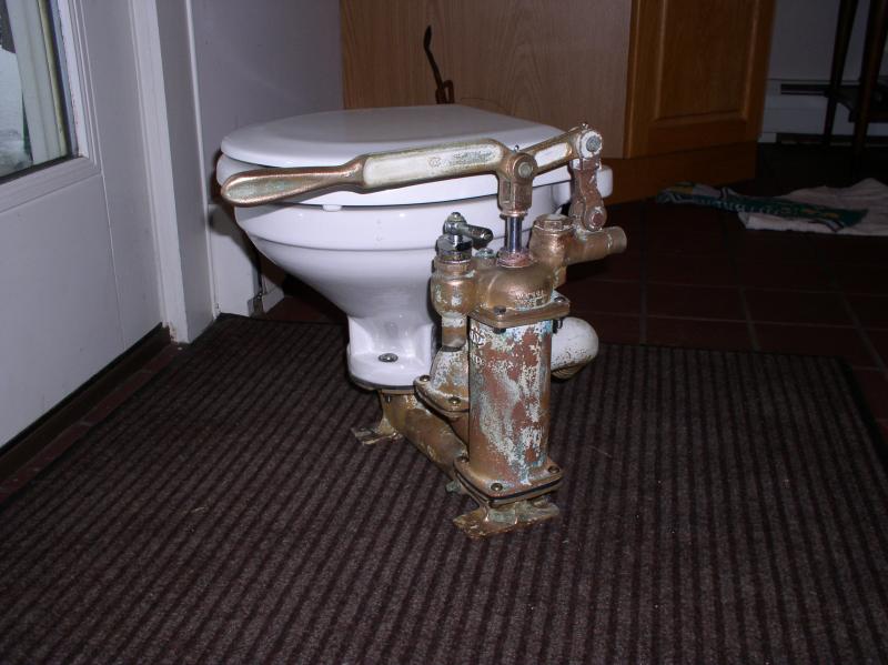

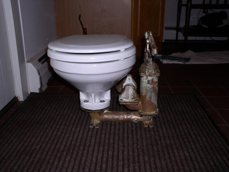

Hi all

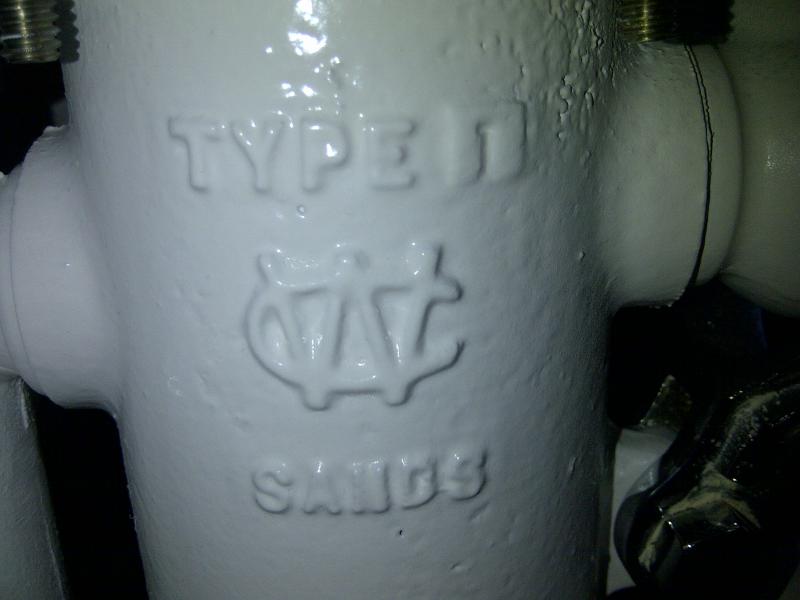

Need some help trying to figure out what model head this is, i was told its from the 1930 or so, and on the bronze tube it says type n, i do know the chrome is not orignal as the last owner had this done, the head is in great shape and it would be a shame to throw it out, i was hoping to find a rebuild kit for it, seals and gaskets, i was also told it could be an orignal imperial or junior model but not shure of this, any help would be great as this would look great in one of my boats. thanks to all in advance.

I remember seeing these pictures at the sailnut forum. I encouraged you to post here so we could hear Peggy Hall's verdict. She is the "head mistress" after all.
I do hope there is some way you can scavenge most of the parts you might need for a 'service kit' or fabricate your own parts. It really is a unique looking head. It would be a pity to have to get a new one for lack of spare parts. They don't make stuff like they used to.

Thanks for the advice I hope to get some info on it here, all parts are there the only thing im missing is the rubber parts, i may order the rebuild kit for a newer head and try to make it work, ya you just dont see workmanship like that anymore. Its worth saving at any cost

I'm 99% certain that model is the W-C "Winner" and it is from the 30s, maybe even the 20s. The last one I saw was on a Trumpy from that era.
Thetford Norcold bought Wilcox Crittenden several years ago...and then, because there isn't anywhere near as much profit in repair parts for high quality bronze thrones built to last 100 years as there is in repeat sales of cheap "disposable" toilets built to last only a year or two, they discontinued the whole W-C line including repair parts. Except for what few parts are still left in inventory, repair kits for more recent models--Skipper, Imperial and Headmate--are about all you can still get. BUT--there's one person at Thetford who'd know if you can still get anything for the Winner--Jock Allpress. Send him an email: JockO@thetford.com. He's pretty good at responding.

Thanks peggy, this puts a name with the head i will try to e mail jock and will post a reply with findings

The Skipper and Imperial kits are the only ones are likely to have ANY parts that would fit the Winner...and I wouldn't spend $150+ unless I were sure that at LEAST 90% of 'em will.
These toilets are in a completely difference class than the most popular manual toilets. They cost $500-$700 25 years ago...are solid bronze (a shame the PO chromed the bronze 'cuz salt air does pit chrome) and built to last 100 years--which explains why the kits cost more than than a whole compact toilet. W-C--and also Groco, with their EB (also discontinued now) and model K toilets--designed 'em to be clones of the British toilets. Blakes Victory and Baby Blake...the undisputed best manual marine toilets in the world. The Blakes Victory has a price tag of about $10,000 (no, that's not a typo, that IS $10K) at today's rate of exchange and is only made to order. The Baby Blake is quite reasonably priced by comparison...only about $3500 at today's rate of exchange. The owners of these toilets rarely leave 'em on the boat when they sell it...they take 'em to the next boat.
The whole concept has become totally obsolete because our society now puts immediate gratification (quick profit) ahead of quality, reliability and durability...and not only mfrs, but consumers. I can't count the number of people over the years I've run into who've told me they took one of these wonderful machines to the dumpster because they could replace it with a Jabsco for less than the cost of the kit.

See, Peggy knows her heads.
A quick internet search turns up the service kit for the WC "Winner" head: http://www.defender.com/product.jsp?path=-1|51|806|315199|315203&id=199113
She also makes it sound as though you should buy a bunch of these kits before there are no more - as they are not making new ones anymore.
My link shows the kit laid out (if they actually still have it). I still think you could make some of the rubber parts from an inner tube tire (or tyre) and cobble the rest of it together from various bits of metal and plastic. It would be best though to use a bona fide service kit to figure out how to fabricate one if/when you have to.
Hopefully the 'Joker valve' is more or less universal.
As always, Peggy's depth and breadth of knowledge on marine heads is evident.

Your info has been a real help, i did e mail jocko and he did confirm that it was a very old winner and he was going to try find old pics or info on the head, i was on the defender marine web site and there was a rebuild kit there for the wc winner head i ordered this kit $99.99 if it works it will be worth it for me, i will post later if this kit works.

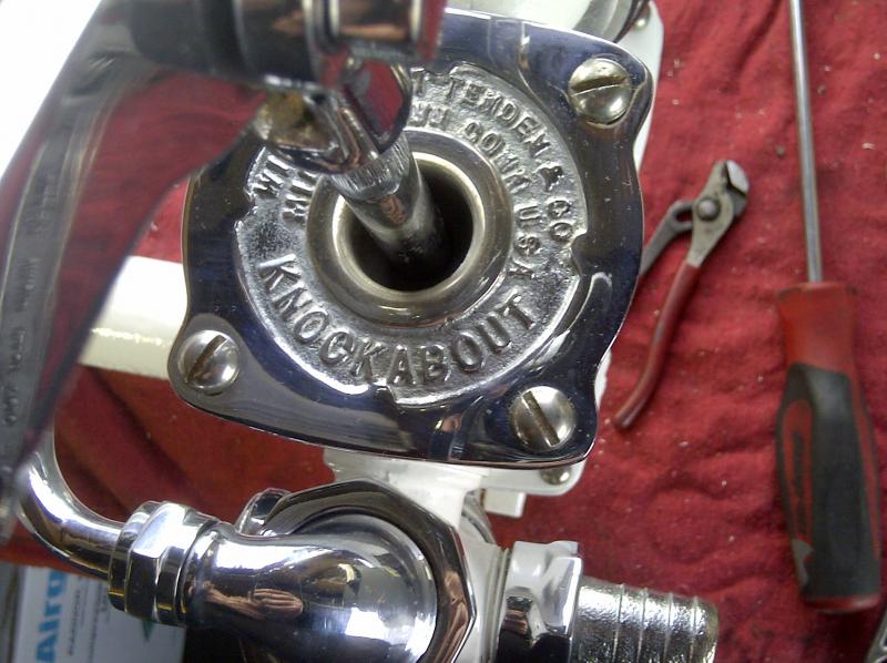

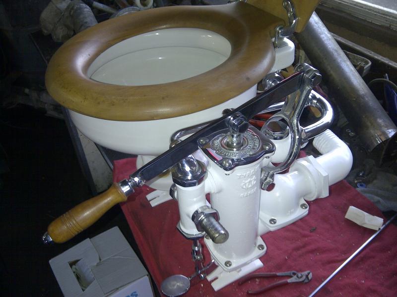

3
Crosby 25' Catboat Brunswick
I don't think that's a 'Winner' as I have one on my catboat. I think it's a model or two up the ladder, and as soon as I can find my WC catalog from the 1930's, I'll let you know.
Speaking of 'Winners', what would be the best size holding tank to consider for these heads? My boat came with one of those 3 or 4 gallon tanks and a Y-valve. I've rebuilt the head (still have one repair kit left), and am thinking of installing a better holding tank. I'd like to have a outlet for the pump-out, and a separate outlet for an overboard pump.
I get the impression that these old pumps use more water per use, so I do not want to undersize my tank.

They're both Winners...the Winner is the only one that had that pump handle design...but yours is either an earlier or later version. I could have have mis-identified his...but I don't think that Jock Allpress--who was with W-C for decades before Thetford bought 'em--would. I suspect his is the later version, 'cuz the Winner pre-dates the Skipper and Imperial and by the time they came along, the pump had been redesigned to, among other things, replace the wet/dry lever at the top of the pump with the completely separate foot pedal operated intake valve on the base that was common to all the W-C bronze "thrones."
