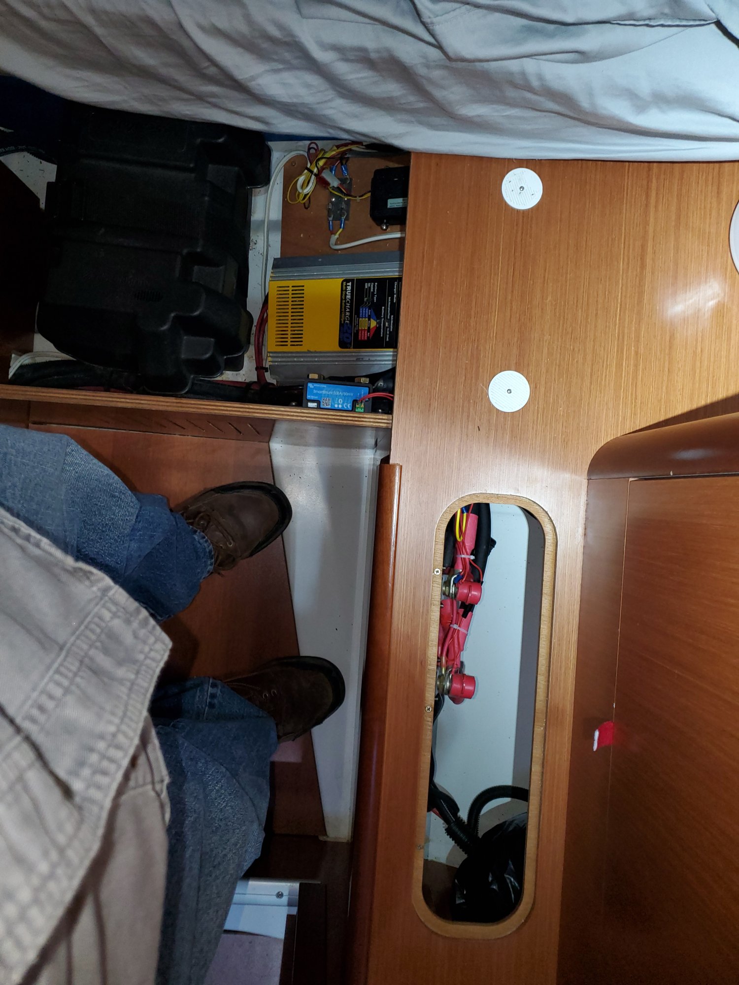

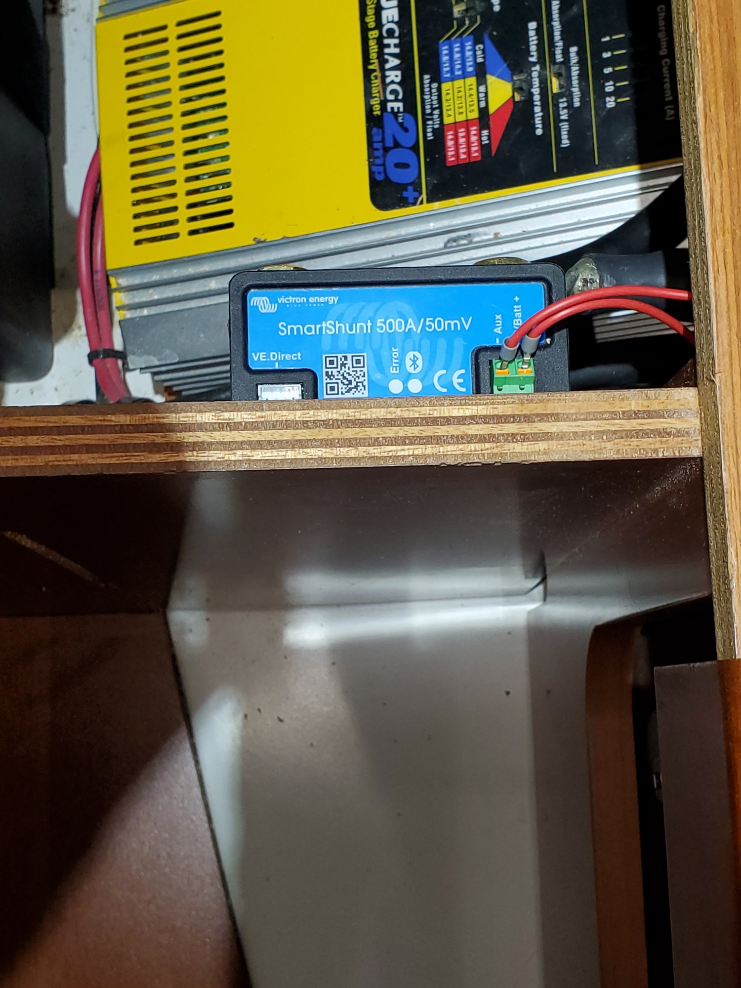

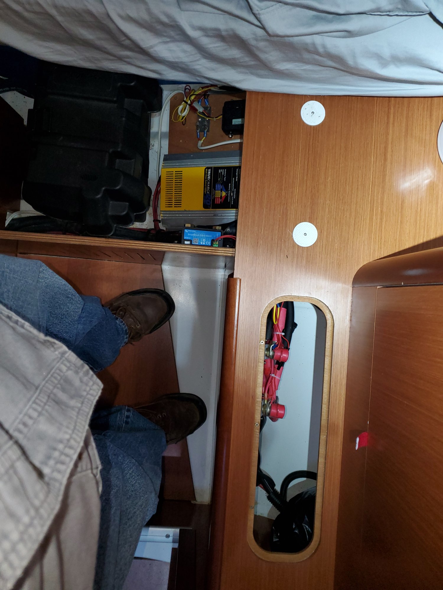

I installed a Victron Smart Shunt today. It took less than an hour. So far I really like it. It's basically the same as a Victron 712 battery monitor but it doesn't have a display. Instead of a display it uses a bluetooth connection to a smart phone. I didn't want to cut a hole I my nav-station to mount a display anyway.
Here are a few things I discovered.
1. Beneteau used loctite on the battery switch nuts. I was surprised that they didn't use something like no-ox.
2. The factory switch on the ground had a .2 to .3 volt drop across it with very little load. I don't care for a switch on the ground.
3. The data on the Victron seems fairly accurate & fast.
4. The resting voltage on my start battery is dropping faster than it should. It's time to investigate that.

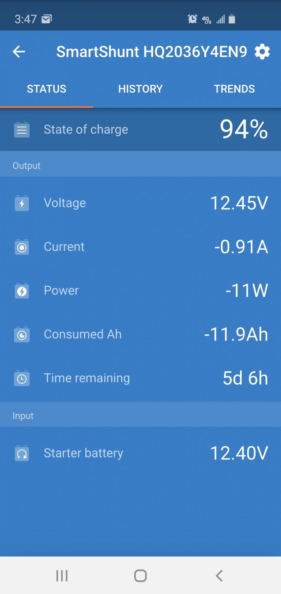

I got to play on the boat this weekend. The Victron Smart Shunt really is smart, it taught me that my stereo is wired to the start battery and not the house. This explains why my start battery resting voltage was low. I suspect this was done because most stereos specify a direct connection to the battery, the tech just chose the wrong switch terminal to connect to. I plan to connect it to the hot side of the cabin light breaker, with a fuse of course. Because I almost never turn the house bank off the memory settings should remain intact. This location also allows the factory shunt to see all the current flow, as well as the Victron.
I also used it to determine that the glow plugs function. Apparently some Yanmars are not wired for operation even though the panel has a "glow" setting.
Seeing the data in real time bears out the fact the incandescent lamps wast a lot of power and refrigeration uses even more.
I'm going to post some screen shots from my phone soon.

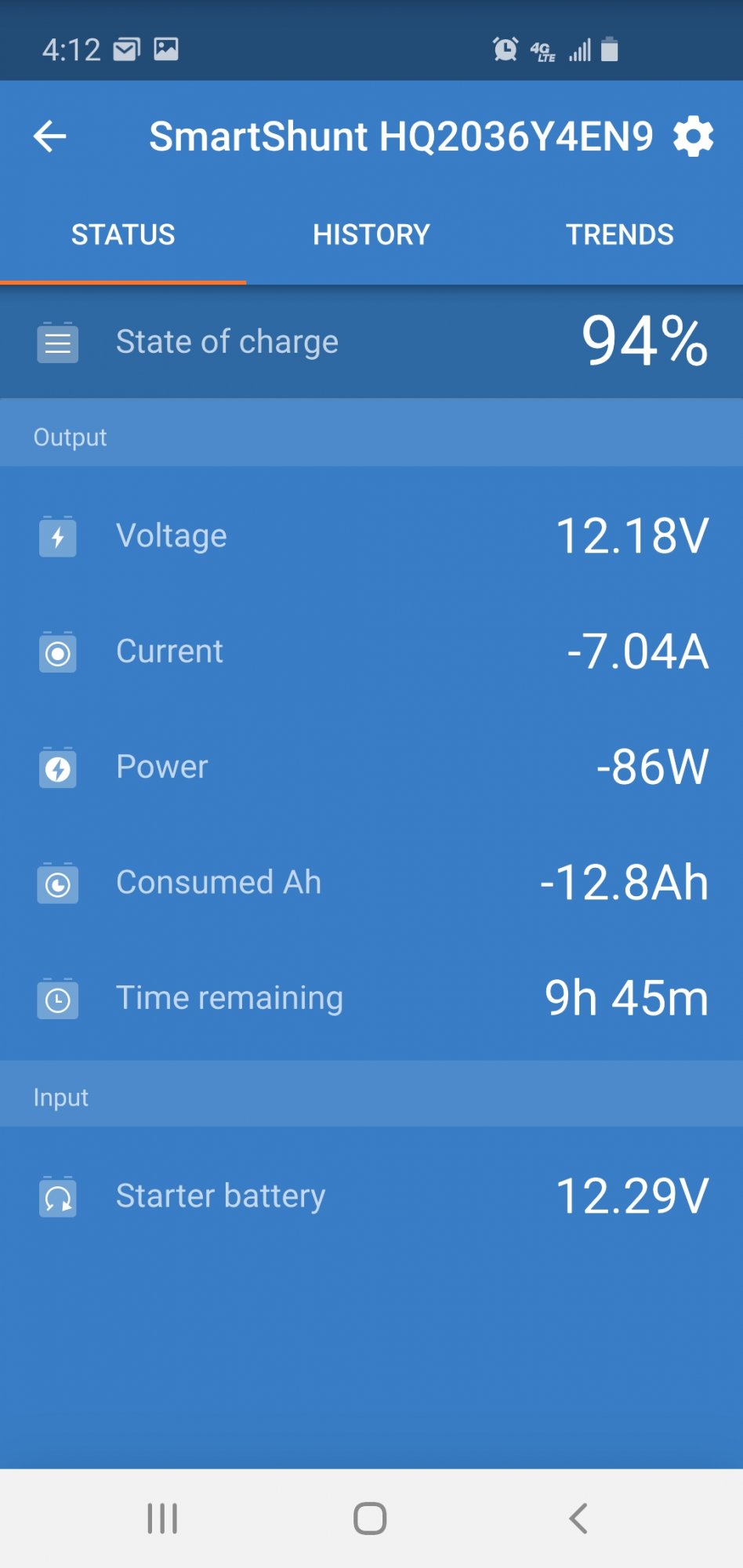

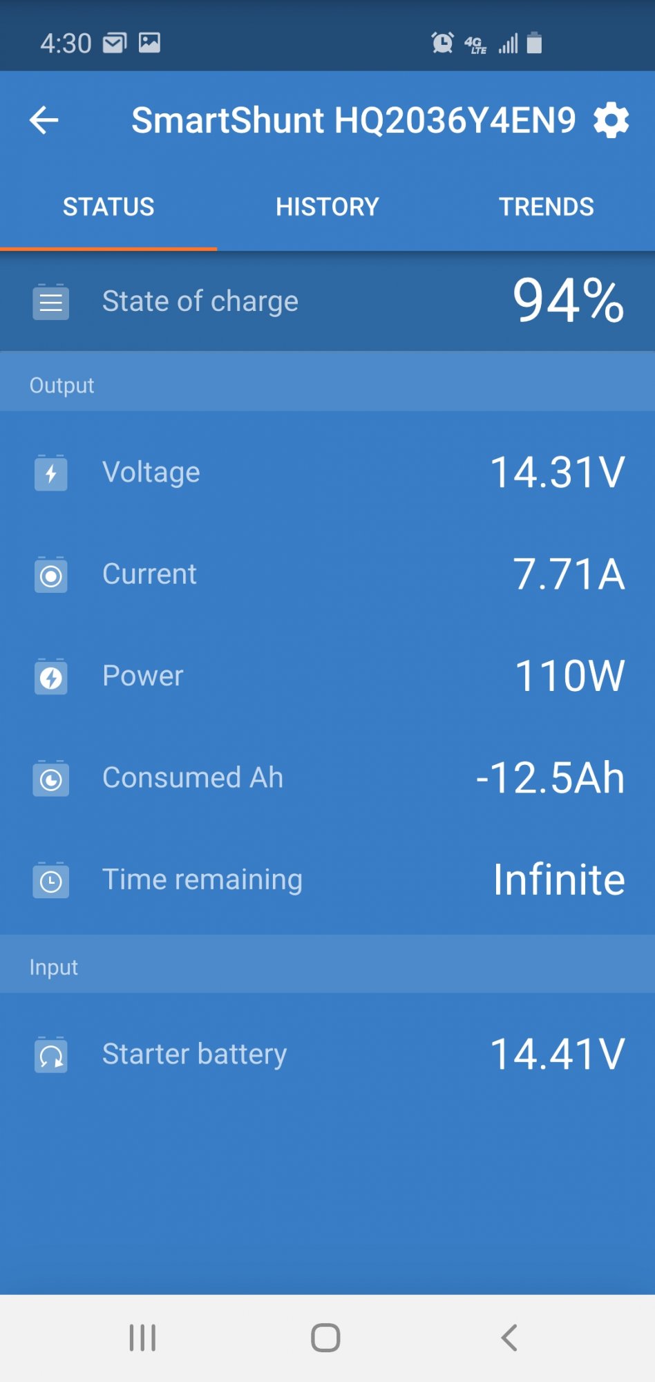

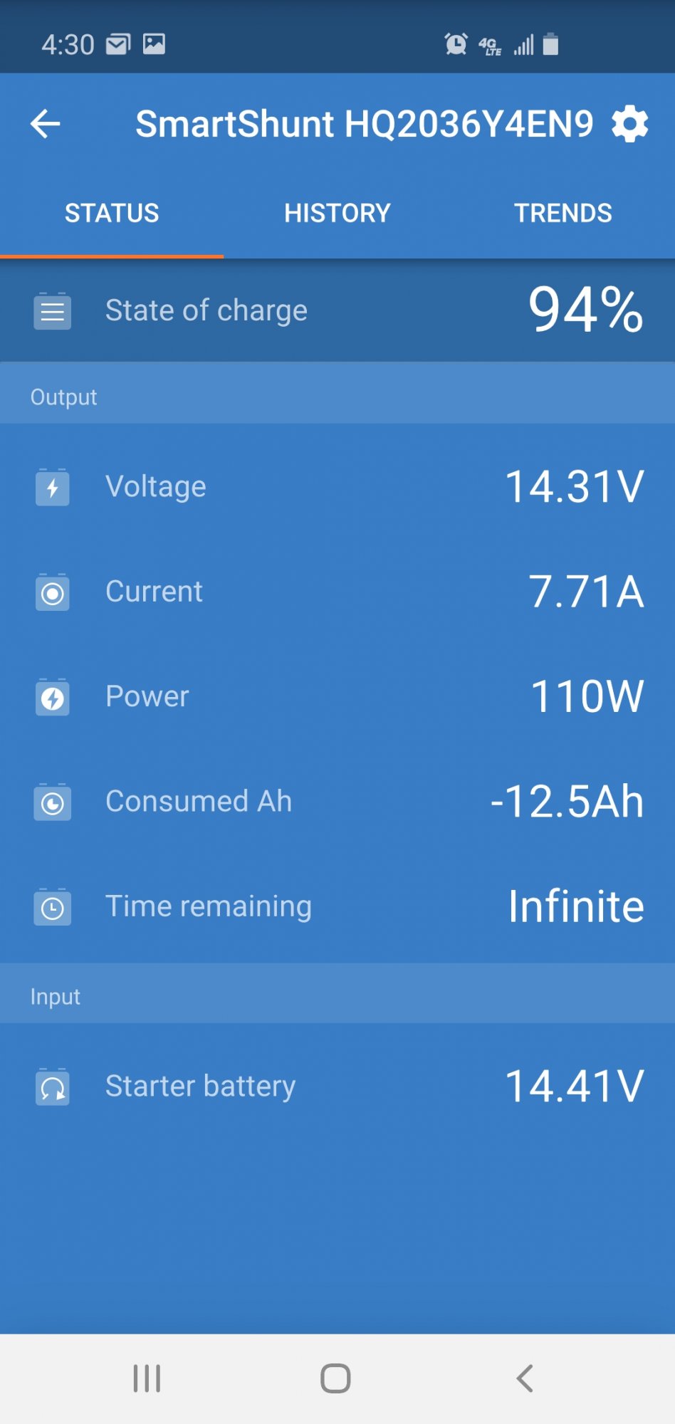

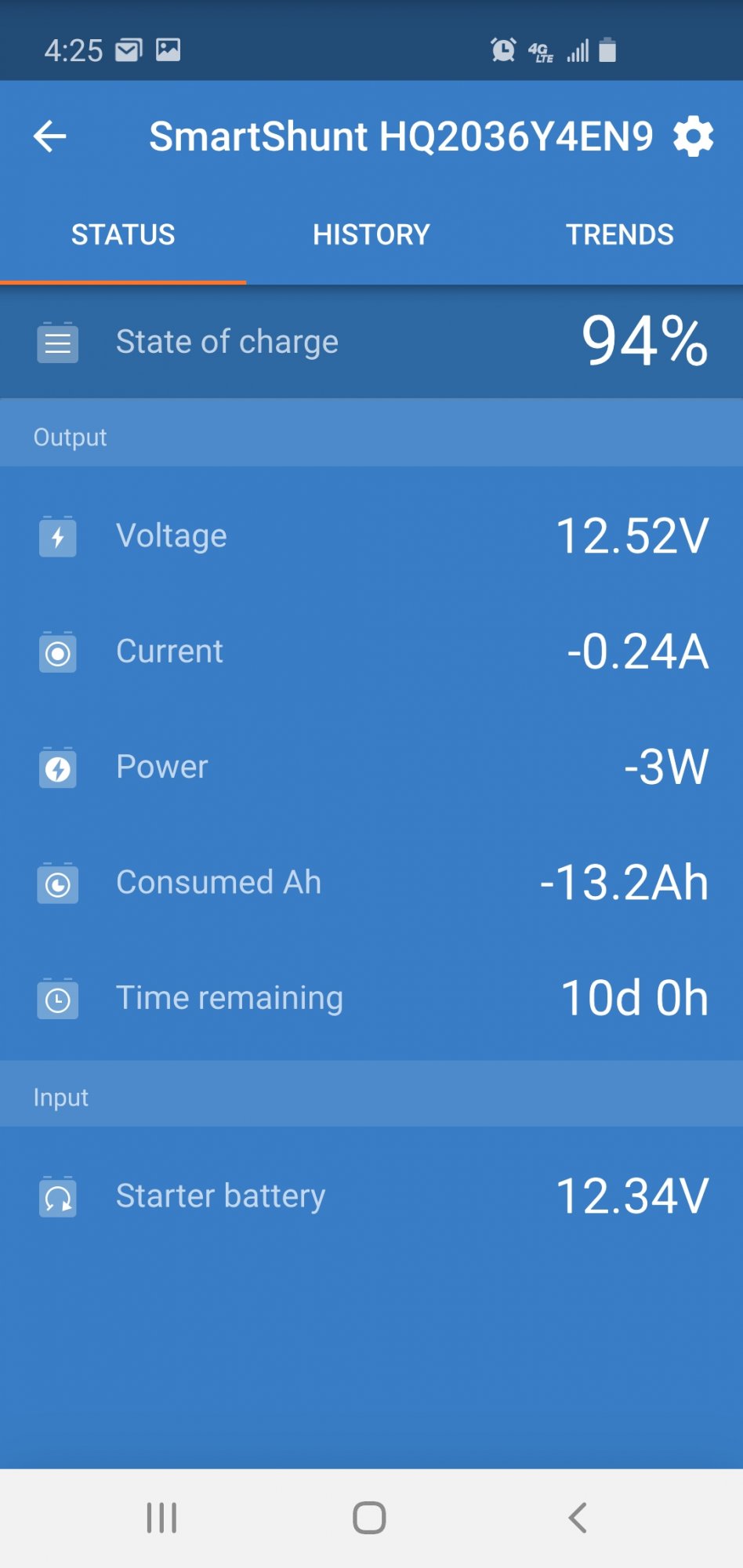

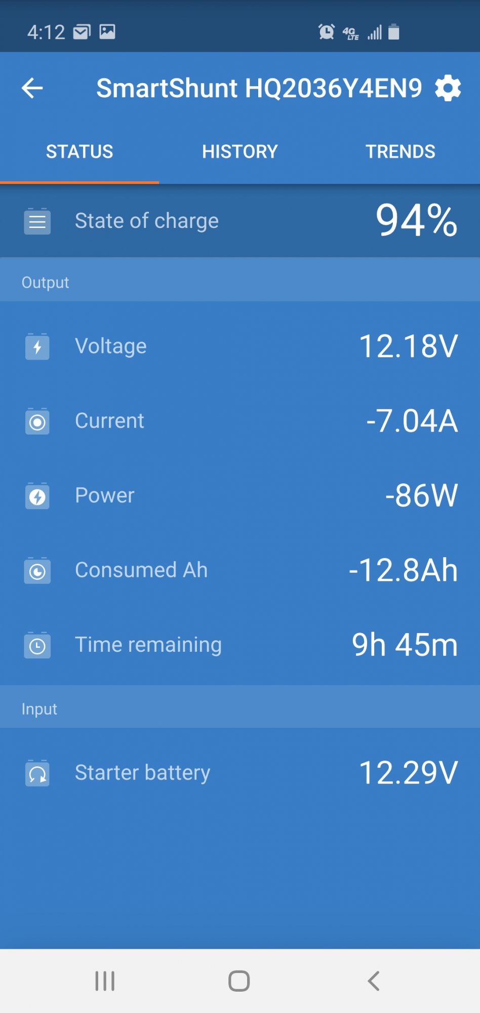

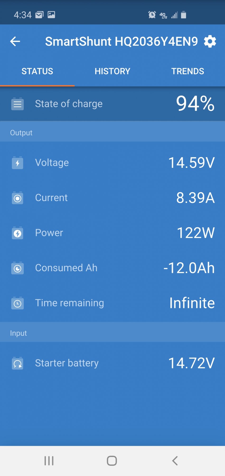

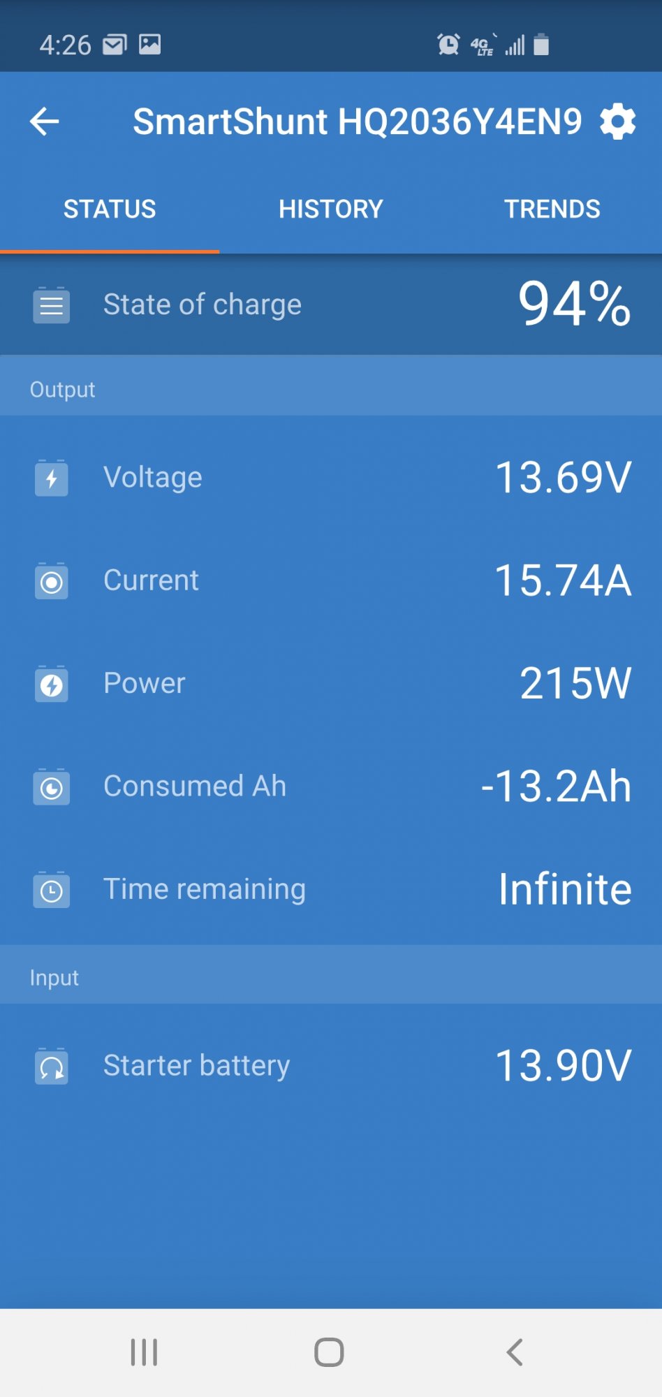

You can see that as I add load with lights and the fridge that the time remaining drops rapidly.
You can see when I turn the charger on and when I change the charge voltage (via the temperature compensation switch).
