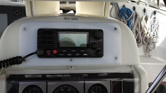

I had to replace my ancient, but well-loved Virgil / B&G helm radio (thanks Steve!). While it was a wonderful radio, the time had come since it was cutting out at low voltages and since the new U.S. Sailing rules require a DSC equipped radio.
Anyhow, I decided to go for broke and installed the new Standard Horizon GX 2200 which has both a built in GPS and antenna and AIS which uses the VHF circuitry and antenna. For the price, you have to wonder who would buy a separate AIS class A receiver anymore. The advantage, besides further redundancy, of the GPS is not having to run another set of wires to the cockpit; that alone was worth the price differential.

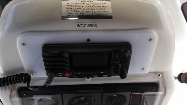

I had two 4" circular holes in my helm, so I ordered some 3/8" HDPE from McMaster-Carr and made a bezel to mount the radio. I hadn't worked with it before. It was easy, if a bit messy. Turned out fine.
One thing of interest is the manual. 152 pages! I'll bet a third of it is DSC use and options. Much of that is emergency and AIS- related communications options I would never remember or use. Maybe some of the others of you would. The functions are soft-key driven, so it isn't as handy as dedicated knobs, but once you get used to it, it's OK but crew won't figure it out. The AIS display on the screen is by necessity tiny, but the range can be adjusted dramatically. I have one below anyway, altho this will be handy for crossing situations.
All in all, it's an impressive piece of equipment for the price. And, it works when the battery is low, since I force-lowered them by running the water heater off the inverter and running all the AC for the rest of the day.
