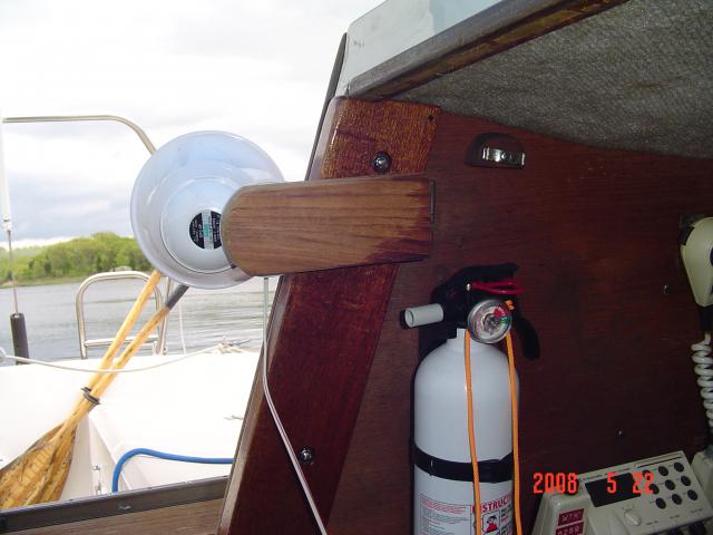

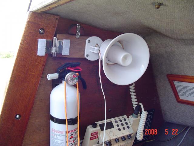

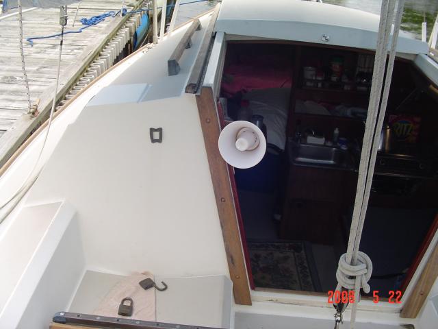

I've got a Standard Voyager Horizon VHF that I bought in 1987 and it's still works like a champ. When I retired in 2000 I was given a Hummingbird hand held which only lasted a few years. I think the battery needs replacing. It's good to have both, but if I had my choice I'd pick the fixed radio with a Shakespeare Stubby antenna at the top of my mast. I mounted the radio just inside the companionway bulkhead and I have a swing out bullhorn connected to it. It's an old radio but it has a PA, Intercom, and an extension speaker input for the bullhorn. It scans and has 40 channels expandable to 55. If you can mount the antenna on the mast you'll get better reception. I have a thru-hull connector for the coax that I bought years ago from CE Beckman. The bull horn is on a swing out at my companionway. Handhelds are OK but fixed VHFs are better and more dependable I think. I also have an emergency antenna in the cabin in the event that I should lose my mast again. I had to use it years ago when I lost my mast out off of Newport. It's only about 6" long and it screws into the radio.

Thanks for your comments Joe. BTW, why do you need that swing out bull horn? Is it to hear the radio better during high winds?

I thought he got that for the power boaters. To yell at them as they create wakes as they race right by you.
