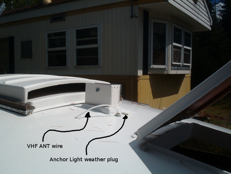

Hiee Merlinuxo,
I just had the cable come out of the deck via a watertight fitting and then used a connector to join that to the cable coming out of the mast. My mast cabling is internal so the cable exits the bottom of the mast as it is a little over an inch above the mast step.
