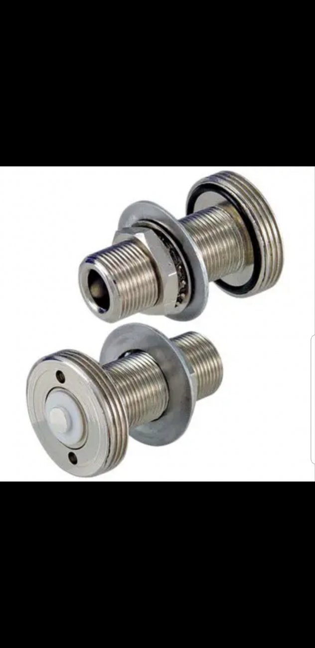

there are proper vhf bulkhead connectors that take a pl-259 on each side; look online at WM in the antenna section

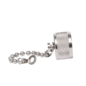

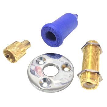

This is a two inch ferrel designed to go thru the deck for a quick disconnect VHF and the adjoin cap to cover up when not used so rain cannot get into it nor leak into the cabin. You will be required to drill a hole in the deck but keep it as close to the size and use pure silicon archeticual grade silicon, not Satan's glue called 5200.
Both by Ancor and stainless steel. Used this for many years successfully. Ancor 2 inch thru deck #200250 and Ancor cap #200252

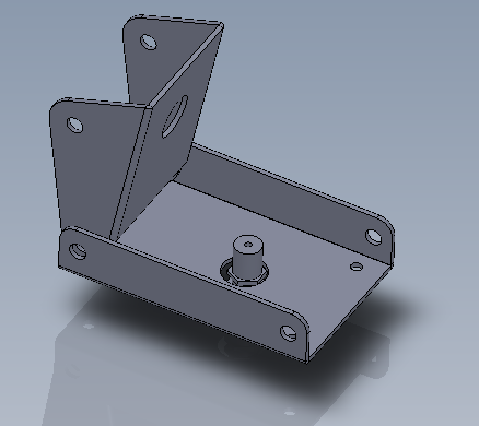

In the end I decided to go with an installation similar to Will Gilmore's. But, for what it's worth, I initially considered using a bulkhead connector of the kind Crazy Dave described, under the foot of the mast, as shown below. The bottom bracket is the mast desk mount and the bracket shown at an angle is the mast foot bracket. (Mast not shown.) For various reasons I determined this wasn't going to work well for my boat, but it might work on yours.

The two inch has locking collars at each end which I used to secure caulking well if I did not have enough length left for a washer on each end followed by the locking collar. If there was enough room left, I did use washers. Either way, it worked. However, I was careful to drill thru the deck for the size of the item taking into account I had enough room only to use the locking collars on both ends. The key is a tight fit. It worked well for me either way.

Funny, it uses the ancor two inch thru deck fitting. Not sure how it would look like on top of the deck but I still prefere a low deck fitting so one will not trip over close to the mast with VHF wire exiting mast at an angle.

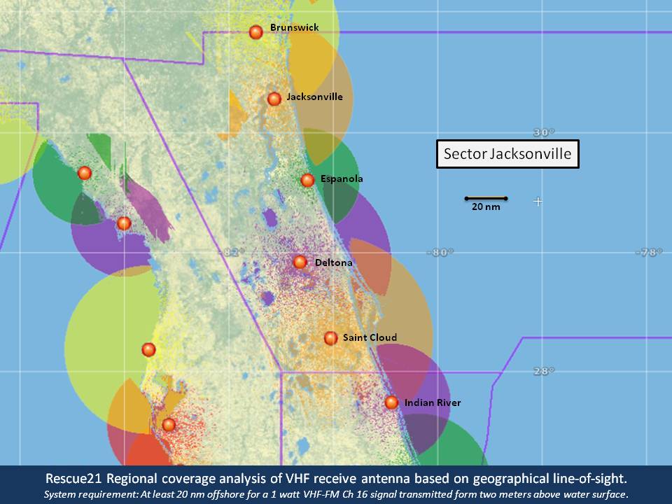

Carrying a portable VHF radio should give you access to USCG help out to about 20 miles. Here is a graphic of the coverage.

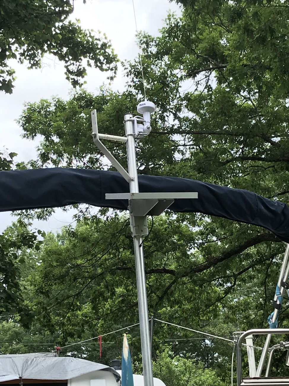

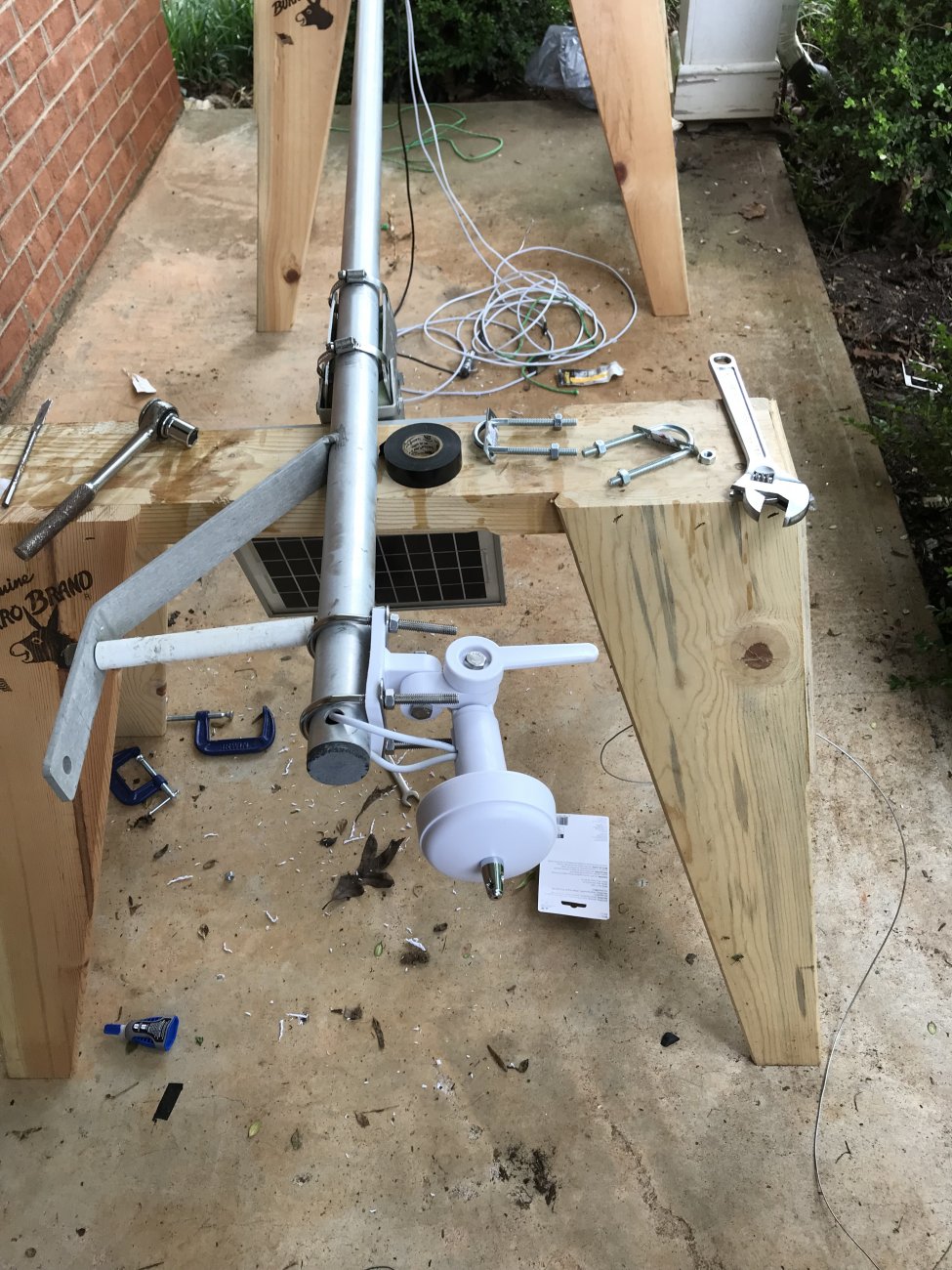

You could split the difference ... I mounted mine on the mast crutch pole on my stern.....here is what I did with my VHF antenna... this is a dual VHF and GPS model. You can also see a solar panel on the same pole.
