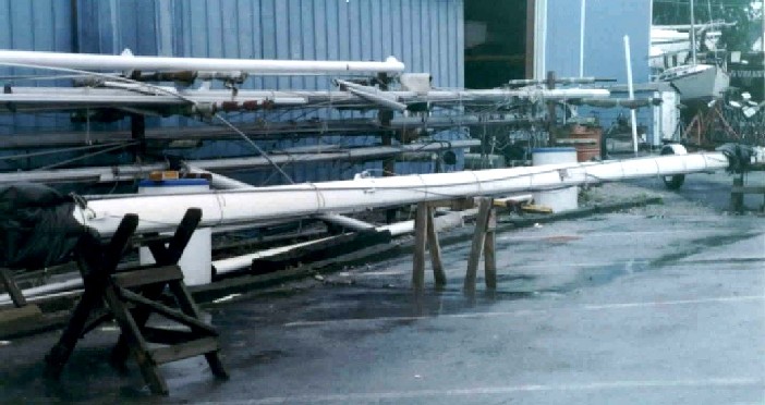

Your quote makes me glad I pulled the stick this past Fall. A few days before the Spring launch they will put the mast where I can work on it for a few days and replace the coax myself. On my H37C with the Kenyon mast the wiring is all within a channel behind the sail track. And it's tied in there. The only way is to slide out the sailtrack and snip the ties. The question about whether your coax is anchored in there is why I do my own work. You could learn that easily. Someone on HOW here will give you the straight skinny. I would recommend paying them to unstep and put the mast where you can work on it. It is not difficult to rewire. My plan is to do the electrical at the same time since it costs a $100. each time they step or unstep.

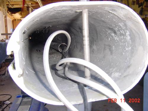

My H33 has a deck stepped mast like the H27 so the photo may be of some help. On the H33, all of the wiring is contained within a pvc conduit which in turn is riveted to the mast. The wiring itself is free within the conduit. I have just rewired my mast and it was a straightforward thing to use the existing wiring as a lead in for new wiring.

Ed, I recognize the exact location of the photo you sent! I, too, would replace all electrical, IF I elect to do the whole thing with unstepping and stepping the mast. The mast that I have, appears to have the sleeve in it and the wiring (near the foot) seems to not be attached anywhere. Even if it is, does anyone know if there is enough room to run the new line thru, IF I elect to leave the old one inside? If so, has anyone done this without dropping the mast? Thanks, guys, for the input.
