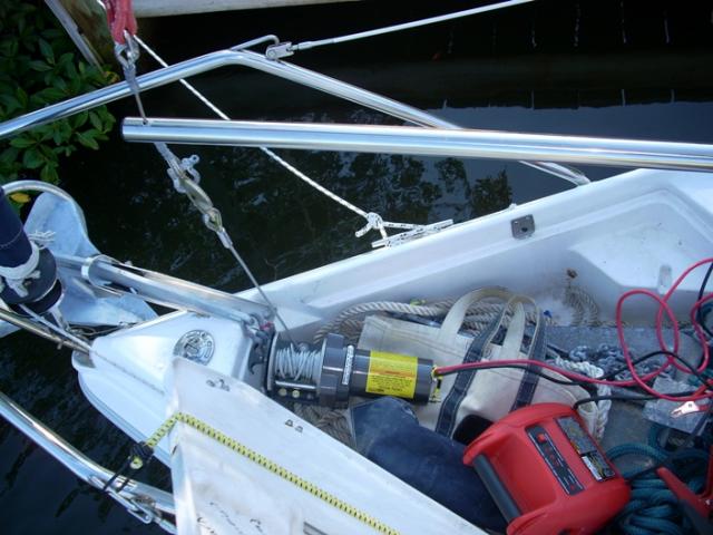

Mine has been up/down over 50 times and there is no sign of fatigue but you can bet I'll be checking it before I use it again. Doesn't it come with two crimps on each eye? Looking at this pic of mine it almost looks like there are two on each side. I already run both the spinnaker halyard and the unused jib lead as double safety but a crimp failure would be the worst.
Maybe a short "leash" between the eyes would be a simple backup.
