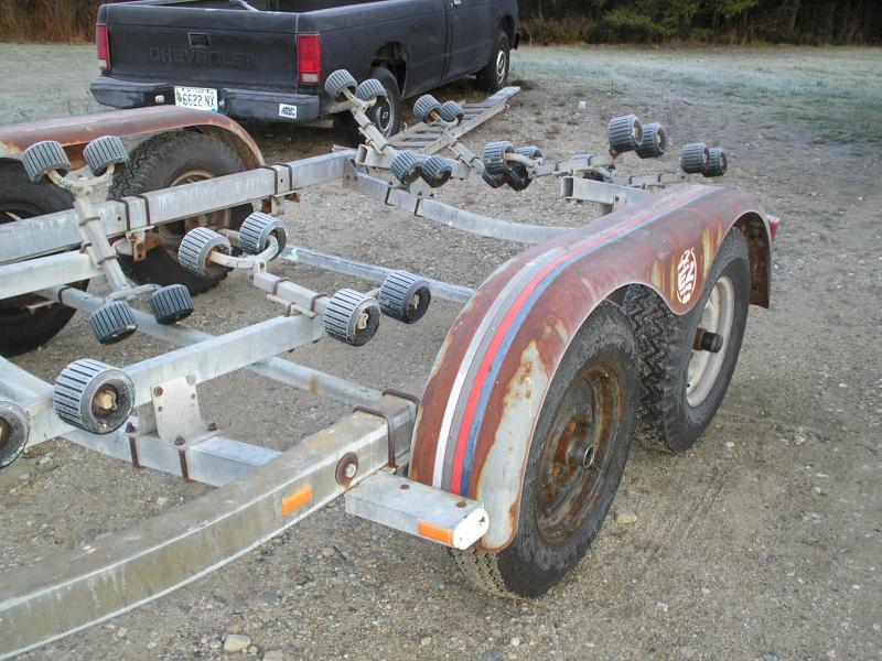

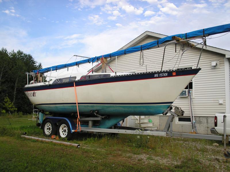

Faris,
I bought my Lancer 25 with no trailer. I ended up buying an EZ-Loader for a power boat and raising the roller assemblies up on posts. It works great. I've also heard of folks using a cradle bolted down to flat bed, if it's just an occasional thing. If you can, find one on a trailer. Stop by with a camera, a sketch pad and a tape measure. That's what I did. What's the likelihood of finding my exact boat, on a trailer, at the exact time that I need it??? I don't believe in luck.
