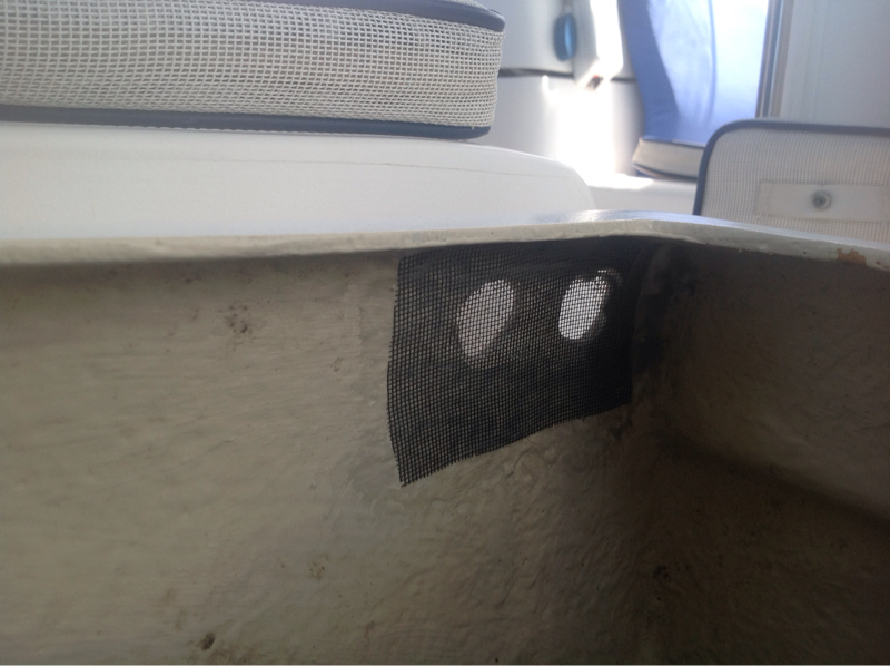

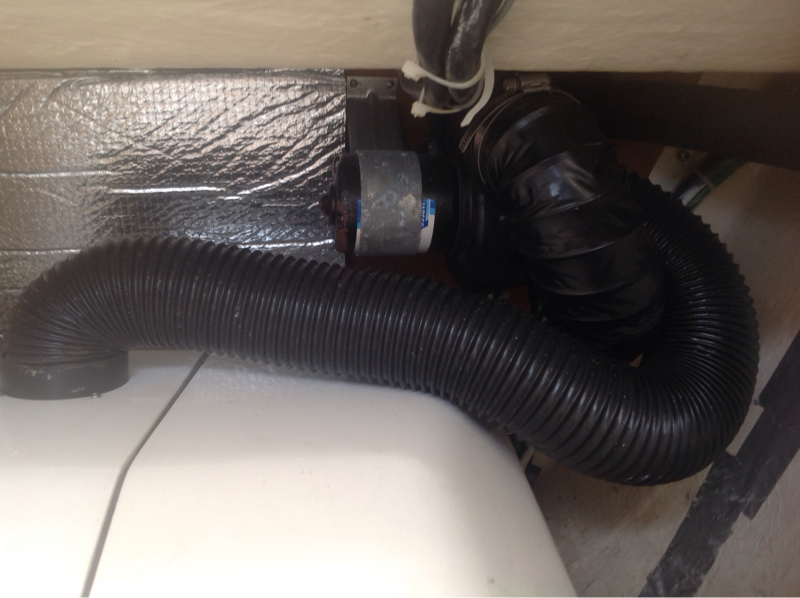

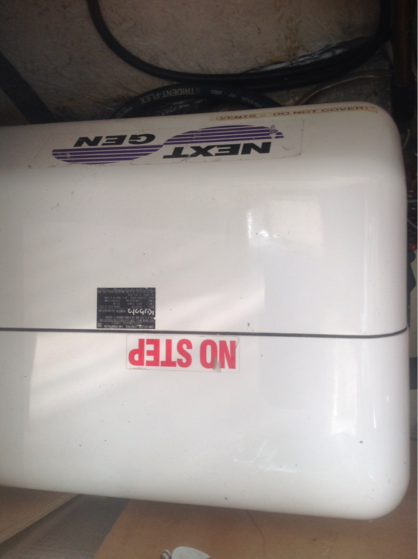

Hi Smokey we have a NextGen 3.6 Kw in the lazarette of our H356. It is in a sound proofing case and the lazarette compartment is lined with the engine room foil/foam sound proofing material. The sound proof case has a Jabsco, 110volt, squirrel cage fan, (4" hose) running from the top of the case out to a Chrome Perko clamshell vent mounted high up on the transom. The fan is hardwired to the output of the generator. It seems to work fine. We have about 950 hrs on it now. The sound proof case has a side vent for air intake. I drilled a few 1" holes at the top of the lazarette for an outside air intake. These holes are along the sides and can not be seen when the seat is folded down in the normal position. I glued some window screen over the holes on the inside to keep bugs out. Any other questions let me know, Bob
