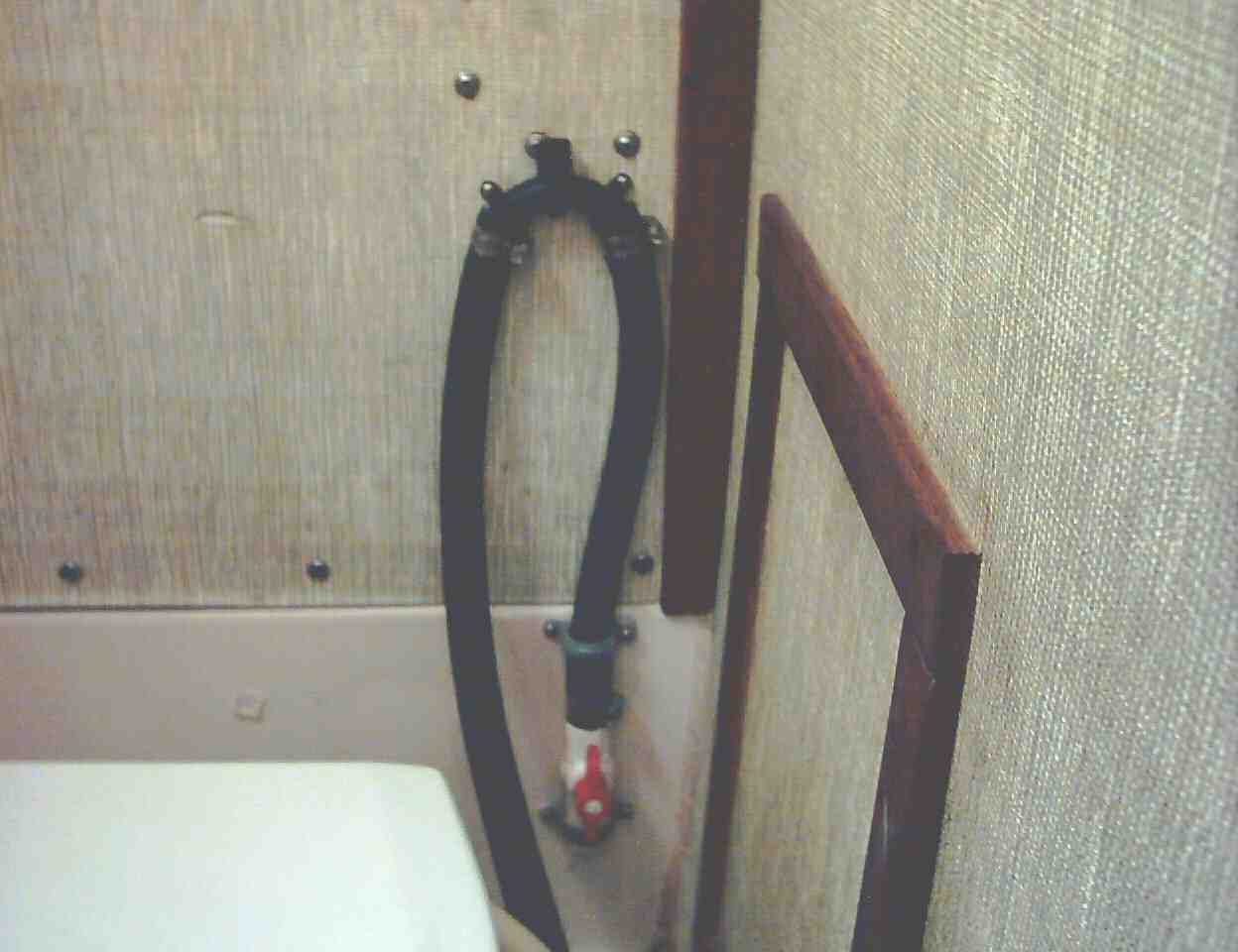

Same result with the installation in the head of my 33. A lot of pumping will make it work. I put the loop inside the head attached to the aft wall. You are right covering the top hole on the loop makes the pump work much better. As you can see from the picture a valve on the intake makes me sleep even better.
