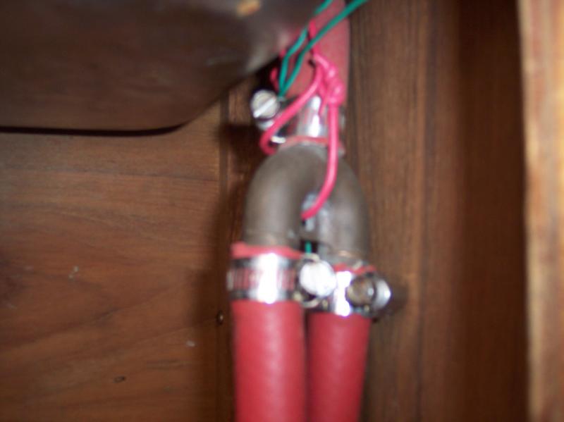

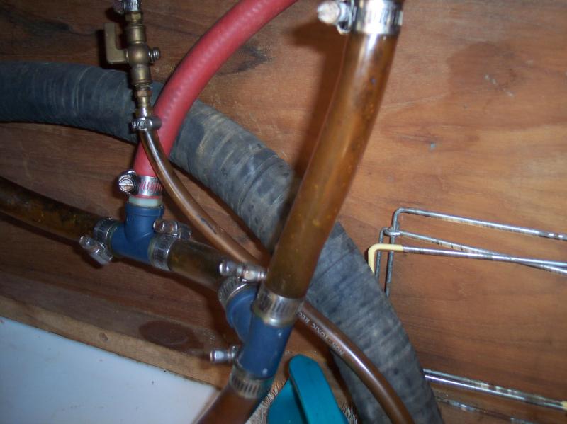

405
Catalina 380 16 Rochester NY
Hi, I have a 1977 C30 and here are a few pictures that I took when I first bought the boat. It is exactly as you describe. A vented loop with the vent connected to a hose that is T'eed to the sink drain...
Oct 5, 2010
322
Catalina 30 mkII St. Augustine
So a hose from the vent goes to the sink through hall. Usually the vent does not leak unless the duckbill is improperly installed. With this set up a duckbill may not be required.
Feb 25, 2014
95
Catalina 30 Grand Lake. Wyandotte, Ok.
Thanks Team 118. That is exactly what I have. Since things have been cut up and parts replaced under the sink I wanted to make sure this was correct.
My boat is a 1978. Just wanted to make sure this was correct.
