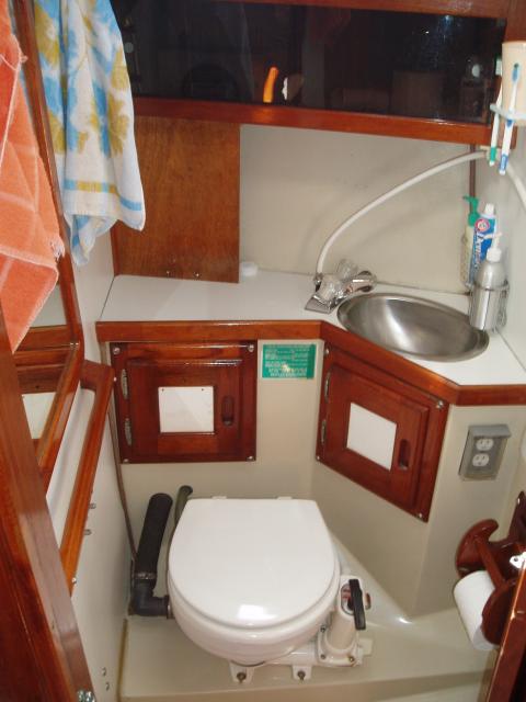

antisiphon vent
my vents for the head discharge and the head intake are behind a panel in the head - see photo. I can access the vents for servicing easily.
