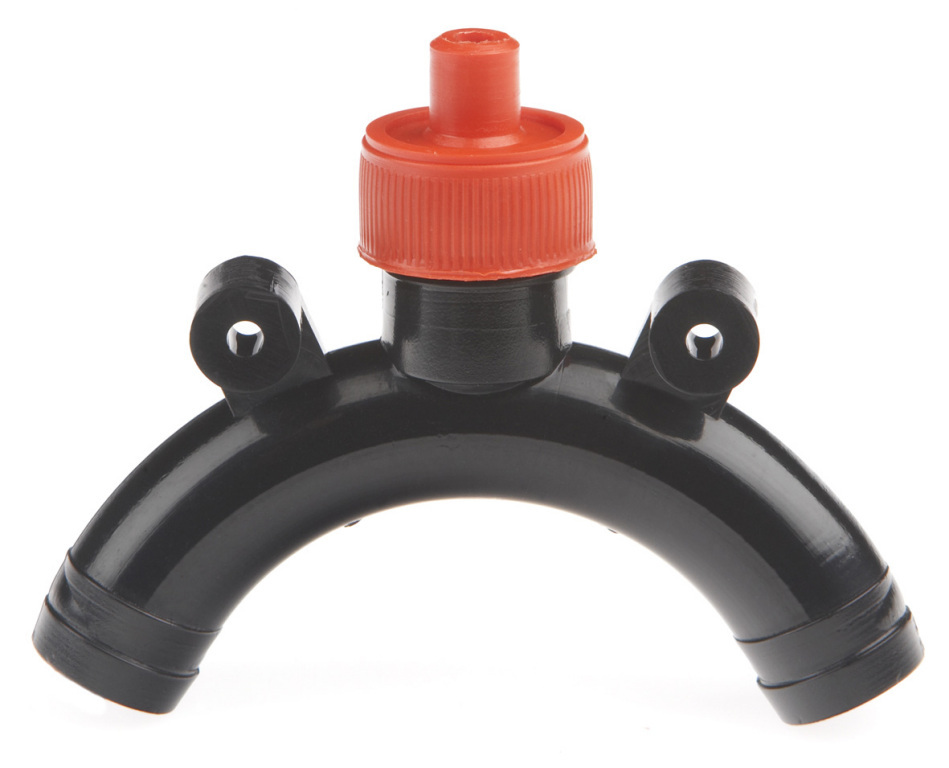

What I should have included but didn't: Your y-valve IS the wrong place, but I'm betting there is no air valve in it 'cuz air valves are sold separately and 90% of people don't even know they exist. An air valve in a line through which liquid is pushed wouldn't open...but if no air valve is installed in the loop, there's nothing to prevent it from squirting out the hole in the nipple at the top of it---which is where the air valve belongs--whether the loop is in the right place or not. Photo shows a vented loop with an air valve in place.

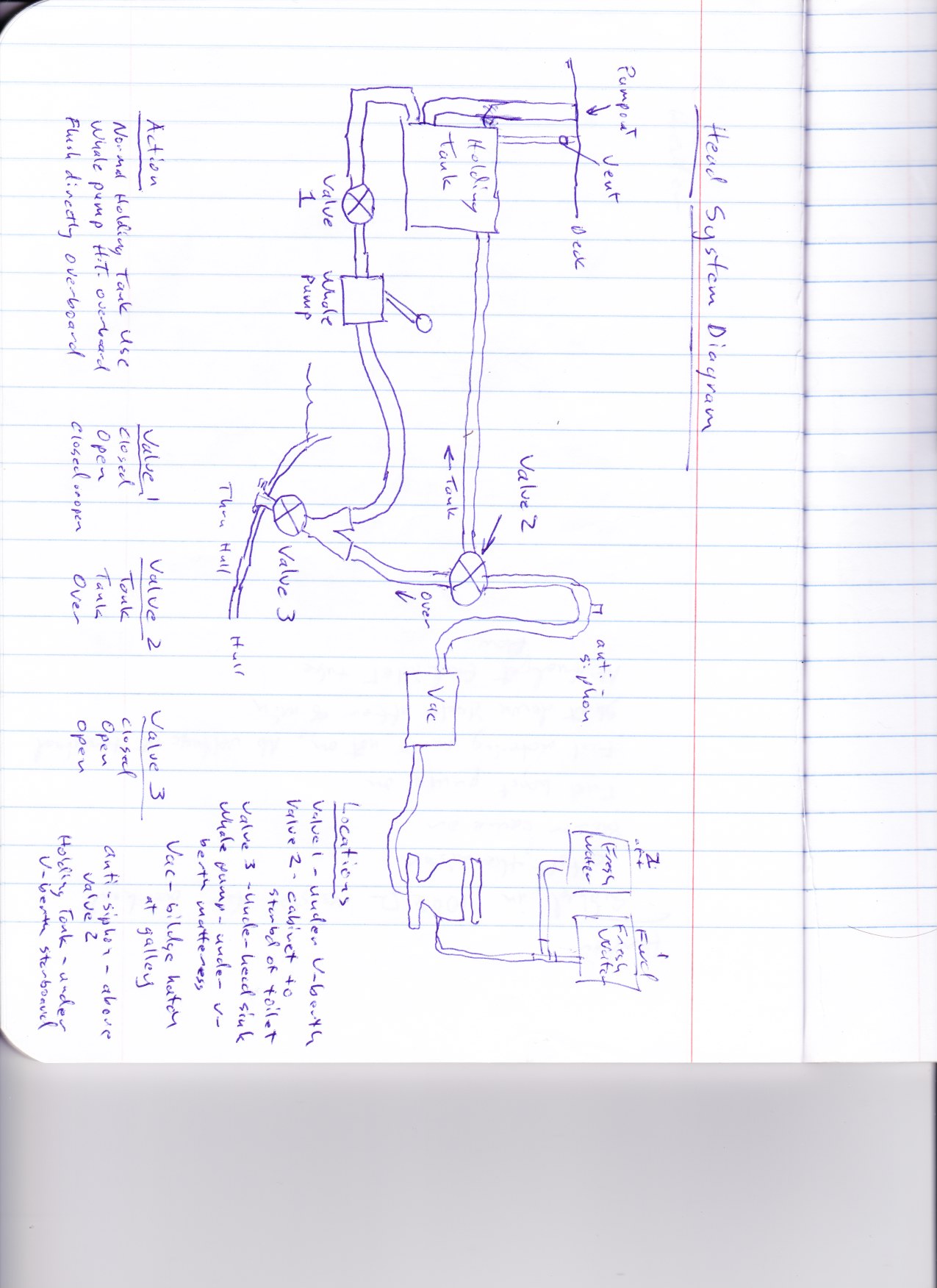

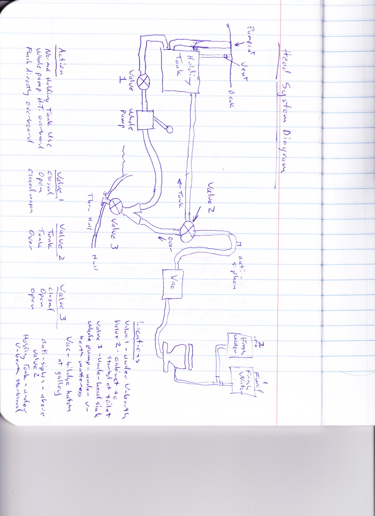

Thanks for the helpful reply. I have attached a sketch of the head system layout on my boat. I do want to make it clear that there is a tiny duckbill air valve at the top of my vented loop. I removed it and cleaned it. It still leaked water. I installed a new duckbill valve and cap there. It still leaks. I hope my sketch clarifies my layout and appreciate any suggested corrections.
PS I want to be sure to state that the duckbill valve is facing the right way, with the "lips" facing into the pipe.

From your description, I THINK the problem may be that you've installed a rubber duckbill valve--which is a replaceable part IN an air valve--without the rest of the air valve. The rubber duckbill should be in a housing that either threads into the hole in the nipple or fits onto the nipple as shown in the photo I posted above. Without that housing, there's nothing to prevent waste from leaking around the valve.

That's the same one as in the first photo I posted. If you're sure you installed it correctly, it's possible you may have gotten a defective one. Have someone flush a whole bowlful of cleanr water while you take a close look at the vented loop to see exactly where it's leaking--squirting out the top or maybe leaking around the bottom of the cap. Then you may want to give Forespar a call: 949-858-8820
