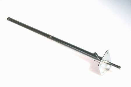

A blocked vent line is usually caused by over filling the holding tank. Over filling the tank forces the effluent up into the vent hose where it dries and hardens especially if there is a low spot in the line. On Catalina's they used a stanchion as the vent and many times that can be reamed out, with an electricians snake and from the deck side by snaking back towards the tank..
That hose is just held onto the stanchion with a hose clamp and the vent hole is on the inboard side of the stanchion about 2-3" off the base plate.
The fresh water vent may be a rusted screen. On many Catalina's they used Perko chrome plated zinc vents for the water tanks. These vents usually have a screen in them of a dissimilar metal and they can corrode and plug. Also any bleach in the tanks that got over filled and came in contact with chrome plated zinc vents will also, over the years, lead to corrosion issues. My guess is that it's the vent its self that is plugged or corroded.
