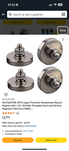

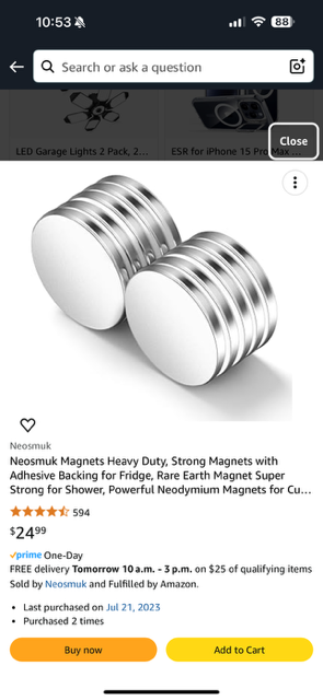

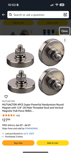

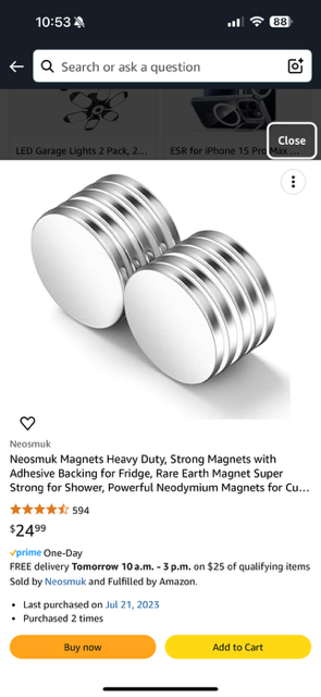

My panels are on my dodger since I do not have a Bimini, but my panels have holes at the corners and on the center of the edges, I simply got studded magnets, installed those on the panels, and with good magnets under the canvas , I just place the panels and put the magnets, never moved, even in big wind storms.
Cheap, very effective, and you don’t need to modify your Bimini
Sounds interesting - do you have any pictures of your setup? My panels have grommets. Which magnets did you get that could be attached to grommets?
