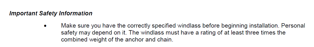

Don't mean to piss on your cornflakes but you might want to check your windlass against your anchor rode.

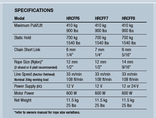

I have a 15 kg. claw with a Lewmar VI windlass rated for 700W at normal loading. What the #$%@&* normal loading means with a Lewmar windlass is anyone's guess. Their specs could drive anyone over the brink and I used to size motors in process plants way back when. I can tell you that the Lewmar Vl is just right on the line for my rode.
I had a quick look at the specs for the Maxwell HRCFF-8. Every bit as bad as Lewmar for BS. Ignore the "WOW factor" maximum pull of 900 lbs. That is the locked rotor pull. Line speed at that point is "0". You have to find their "working load" and apply their factor of safety. Lewmar uses a safety factor of "4". No idea what Maxwell uses. I'm sure Maxwell is an ideal windlass for your application, you just have to know how to research their numbers.
600W is definitely on the small size unless the line speed is very low. This one is right up there at 108'/min. You've got lots of power back there if you're feeding right from the main batteries,so you might as well use it.

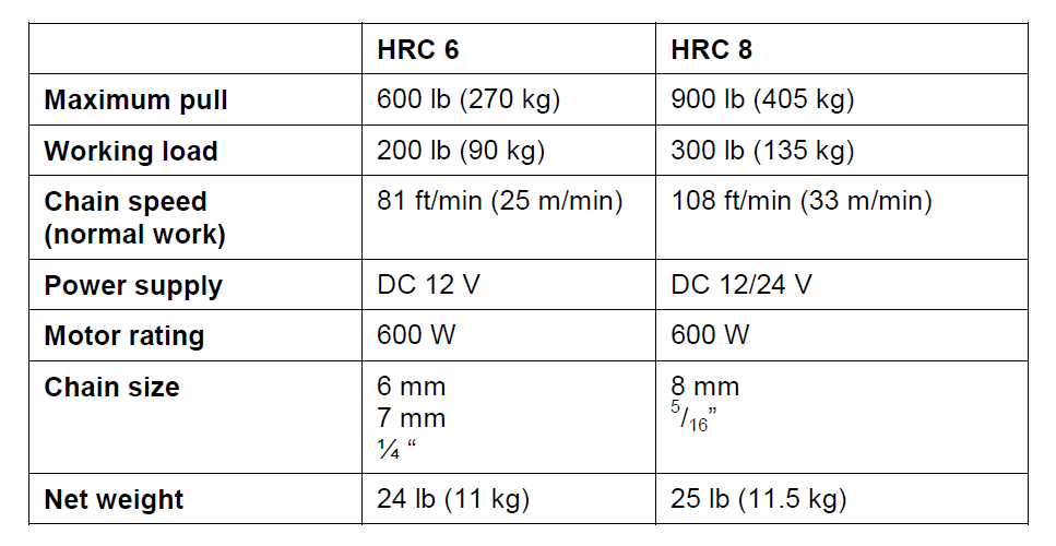

Just a sucker for punishment here. Had to look further into the Maxwell specs and found this:
If you have a basic understanding of power and electricity:
- The HRC 6 needs 600 watts to raise 200 lbs. at 81 ft/min.
- The HRC 8 can lift 300 lbs (50% heavier) at 108 ft/min. (33% faster) and yet still needs only the same 600 W.
- This is a 100.00% increase in work output of the windlass (according to their figures) and yet still requires only the same 600 W.
Right there, they're figures don't figure.
The most important number I was able to find in their literature is the factor of safety they require applied to their working load:
IMHO, I do not believe 600 W is sufficient power to handle their quoted 300# working load divided by a safety factor of 3 which comes out in the wash at 100 lbs.
Actually, glad I read their installation manual. Now I appreciate that Lewmar isn't the only BS artist out there when it comes to pushing windlasses.
