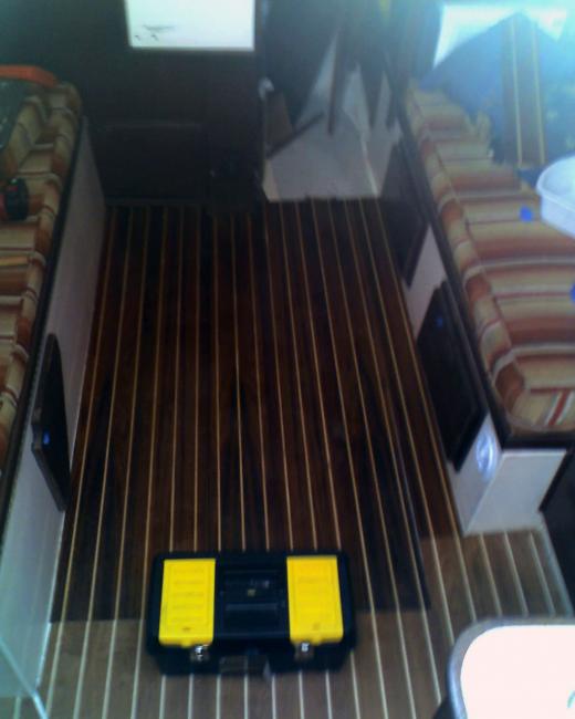

just finishing redoing the teak and holly sole in my hunter and have to finsh the wood. I have some cetol that i used to cover the top with the initial coating to darken the wood slightly. I want to seal the bottom of the wood with something to help protect from condensation / moisture. The topside or floor i want something to protect from foot traffic and wear like a poly urethane i think. Any suggestions? Thanks in advance
