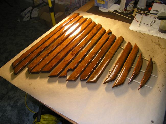

Well I just placed the last coat of varnish on the wood this morning. Things are looking good. Finally got the bubbles under control - just thinned the varnish about 8 parts varnish to 2 parts thinner. Yes I have to place more coats on but it worked. Appears that the surface tension was not letting some of the bubbles pop up through. If this job wasn't so small I would have SPRAYED. Picture is about 3 hours after the last coat. These are the wood pieces off the stern rail seats. Jim S/V Java

Looks great Jim!
What product did you use? How did you prep? Tim R.

I see you like chopsticks too!
Jim, Your work looks great. I use take-out chopsticks all the time too for epoxy work and other stirring and mixing jobs. Much cheaper than tongue depressers and always have some on hand!

How it was done
Thanks everyone - Have to love it when I comes out great. This is the third or fourth time I tried to do something with this wood. Originally, I tried cetol and it held up to the second season. So I sanded that down and tried epifanes that didn't last either. After reading in the Latts & Atts how Bob used MAS epoxy with a UV varnish on top, after emailing asking how it held up - he said great. I said think I'll try that. So, sanded everything down AGAIN, started with MAS epoxy and medium hardener thinned with 10% alcohol. This made a nice penetrating wash to seal the wood. Then applied another MAS Flag epoxy which is thicker. Sanded this to remove any rough spots or drips. Let this sit for three days to insure it was cured. BTW top and bottom were coated in epoxy. Now this is were I got into problems with bubbles in the varnish which was Epifanes. BTW epifanes is what I had on hand. There are four coats on, which was lightly sanded between each coat. I found that by thinning the epifanes, I was able to control the air bubbles to almost none. Operative word is ALMOST. Still have them but ok. Where I do this work is the basement - constant temp of 65, dust almost none. Sanding done in the garage. Now I'll have to wait and see if this can hold up to the elements...... Jim S/V Java
