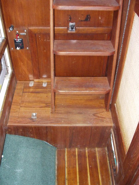

It's dirty photo, but shows it a bit;

I'm glad the finish worked for you. Here's an opinion from someone else on the subject:
Lin and Larry Pardey on teak cabin soles in their book, The Capable Cruiser, p. 179:
There are several reasons why scrubbed wood makes sense. The most important is safety. Bare wood makes an excellent, permanent, easy-to-clean, nonskid surface for cabin soles, companionway ladder treads, cockpit gratings, and toerails. It is the all-time favorite for safe decks, and many state-of-the-art racing yachts have found that a thin teak overlay pays for its weight, since a sure-footed foredeck crew can change sails more quickly and jump ahead of the competition.
