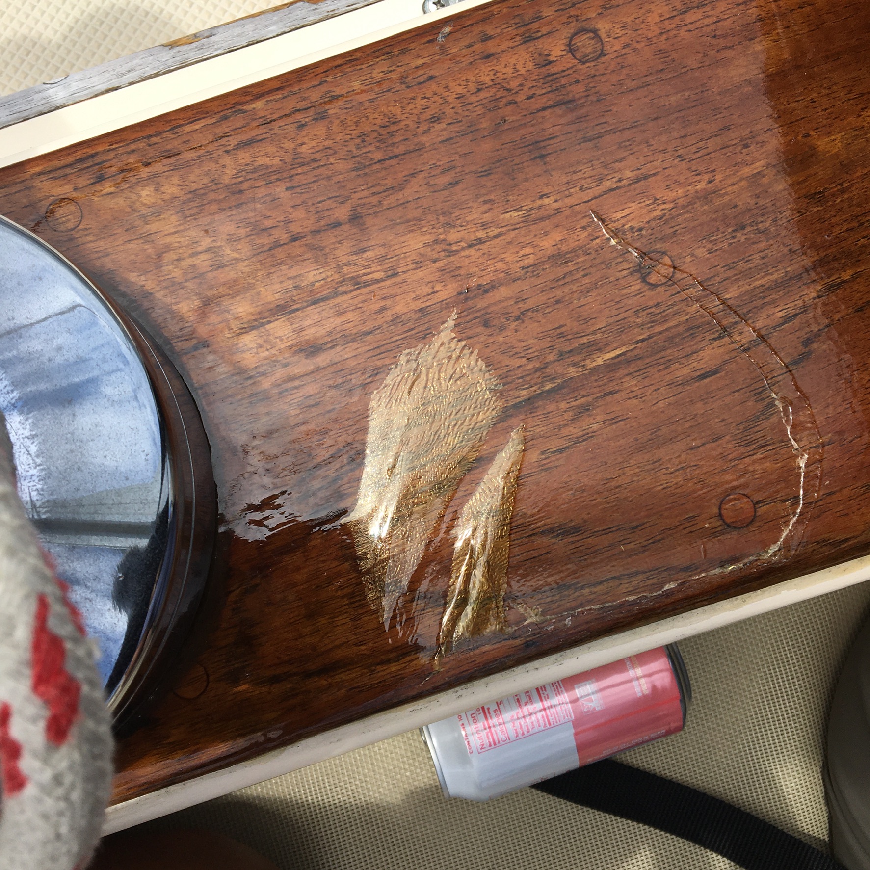

Out if the blue, having prepared the surfaces and varnished…this happened on a pretty hot day.
any ideas?8F1A4EE6-FAB3-4C4F-A07E-B41790DD3118.jpeg6919979C-6826-404A-8C17-C8E394B93C20.jpeg

Looks like moisture in the wood evaporated and lifted the varnish before it could fully dry. I've only ever had this problem with polyurethane in the sun. Varnish usually can breath a little.

The wet wood or wood not completely cleaned statement of @rgranger seems most plausible.
There are different types of varnish. Oil and water do not mix well. I have had best results with the Total Boat products.
Gleam 2.0 (excellent for on deck wood - oil based clean wood, use a rag with denatured alcohol as final cleaning before first coat. Repeat coats every hour up to 3 a day no sanding.)

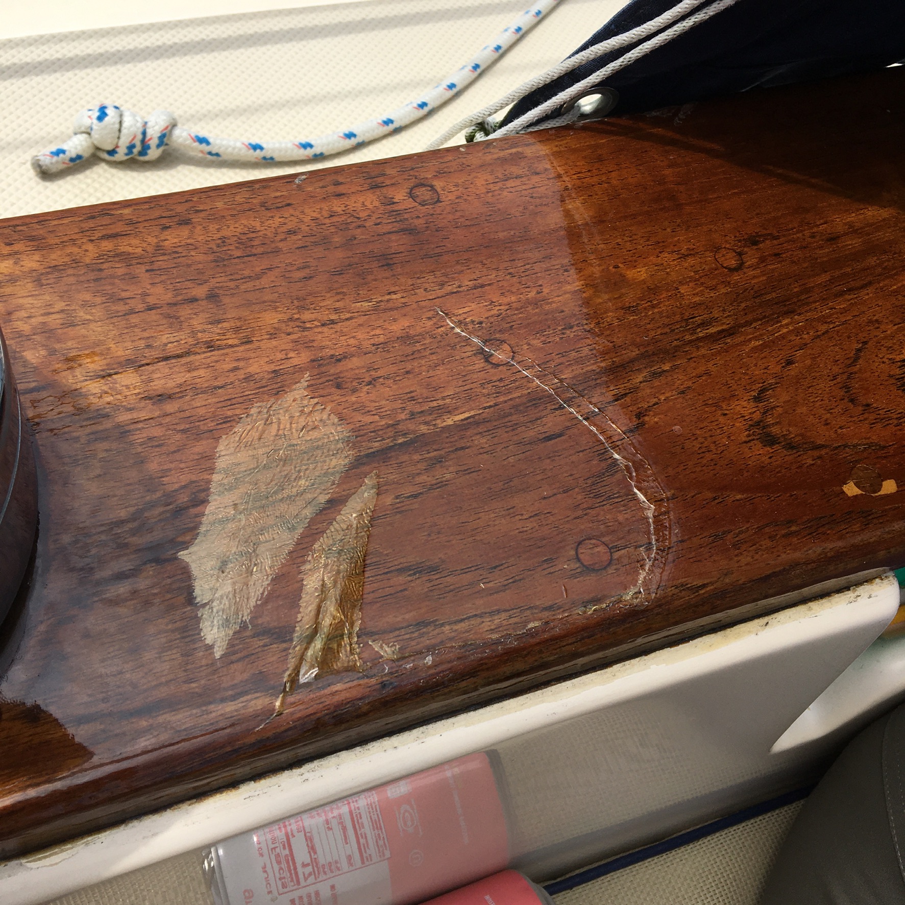

any ideas?View attachment 197215View attachment 197216
Mostly likely some contamination on the wood and/or some moisture in the wood.
This is repairable. Sand the area down to a good solid surface, can be bare wood or existing good varnish. Feather the edges. Meticulously clean the surface try using mineral spirits first to remove any grease, then denatured alcohol. Build the coats back up following the manufacturer's directions.

Most likely something/somebody/whatever touched the varnish when the surface was dried but not the underlying layer. The movement pushed the top layer to the left and created the shear to the right and the uplift to the left. Just redo it.
