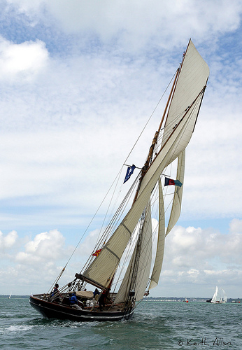

Downward boom tension, either from the sheet, or from the vang, also reduces twist in the top of the sail. This becomes most apparent in gaff and sprit rigs.
Sometimes twist is desirable, sometimes not.
