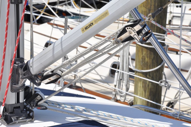

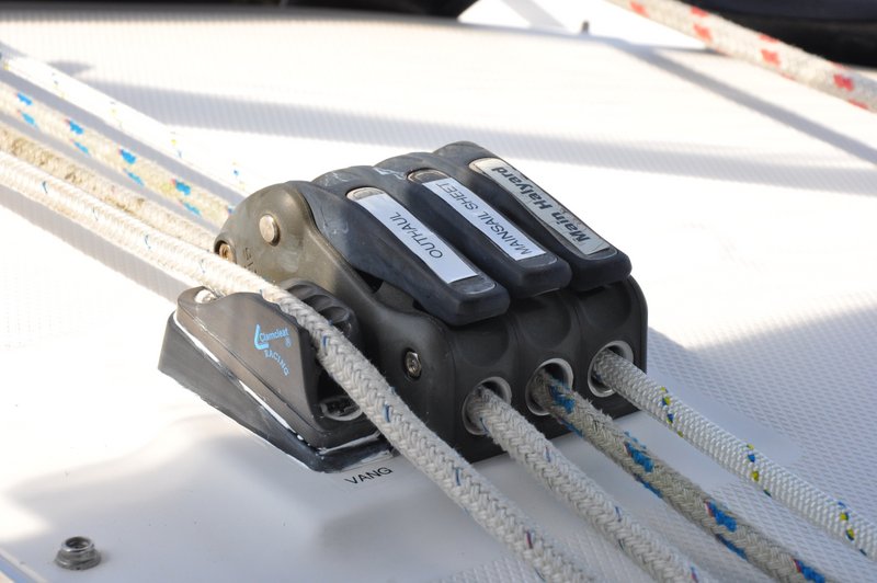

I just did a mod to our vang. I turned it upside down, turned the cam cleat around so the line could run free. Now the the line runs down to a block on the mast rail and back to the cockpit. I had an unused jam cleat in my junk box and installed that beside the line stoppers.
Easy mod to do. I usually release it when I furl the sail so now I don't have to go forward to do that.
