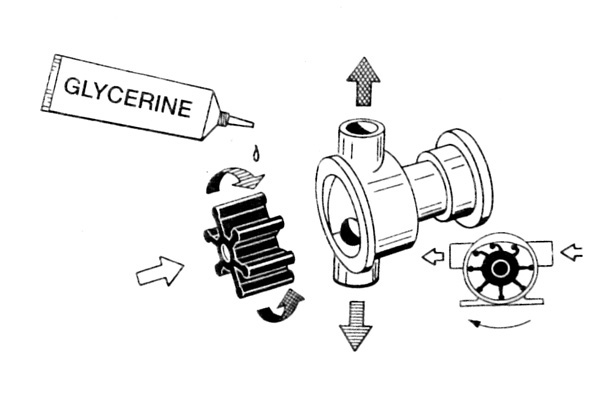

I replaced my Johnson impeller before winterizing the engine, but the engine overheated before I could get the antifreeze in.
Turns out the impeller flanges were directed the wrong way, per the instructions! When I reversed the flanges, the engine ran fine and took the antifreeze. What's with that?
