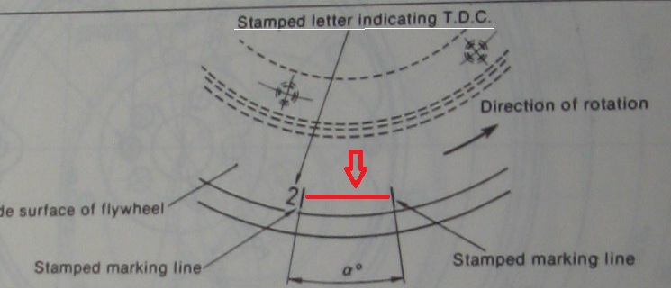

I am adjusting the valve clearance on my 2GM20f Yanmar since it probably hasn't been done in years. Overall this is a fairly simple task once you know how to do it. I am following the Selco instructions and not being a mechanic I am puzzled about a few things. As I rotate the crankcase shaft clockwise (facing aft) to find TDC, I notice on the flywheel there are 2 pairs of notches for each cylinder. In the pic I have attached you can see the flywheel and the span between the two notches(red area). My question is, is TDC on the notch with the number and what is the area between the notches telling me? It seems like a fairly broad area. Does the unnumbered notch mean anything?
Also, I notice that the gap on the rocker is closed when on TDC. Does it take 2 rotations for the gap to open up and can I adjust the #1 and #3 rocker arm on the same stroke, assuming they are off the lobe?

First of all your TDC has to be on the compression stroke and the engine cold. Your matching mark will be at the line next to the "2" in your graphic. Set to the position at which the valve rocker arm shaft does not move even when the crackshft is turned to the left or right, centered around the matching mark. Now you check and adjust the intake and exhaust valves of the #1 piston. With the 2GM you adjust the valve head clearance of the #2 cylinder in the same manner after turning the crankshaft 180 degrees. The clearance for your engine is 0.2 mm (0.0079 in). If you adjust the valve head clearance of the #2 cylinder first, turn the crankshaft 540 degrees. Adjust the clearance of the #1 cylinder in the same manner on a two cylinder engine.

As you rotate the crank clockwise looking aft, the first mark is the fuel injection timing mark. It is about 15 degrees before the other mark. The next mark is TDC for the cylinder marked.. 2 or 1 .. you can be one turn of the crank off, but both valves should be marginally loose when at TDC on compression, at that time, the other piston will be at bottom dead center and its intake valve will be tight

Compression stroke
There is a point when turning the crankshaft that a lot of effort is needed. Is that the start of the compression stroke?
I didnt realize the injector timing mark was the unlabeled mark.
Thanks for the helpful points.
