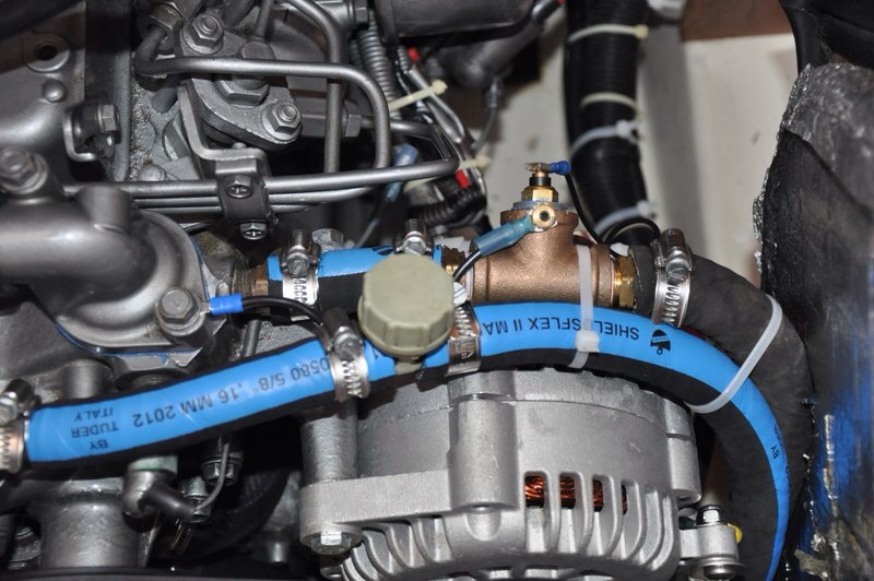

Nick, I followed the same route as the others, I installed it in the hot water tank supply line. I bought the VDO gauge and sender unit together from Defender so they were matched. The sender is in a plumbing T from Homedepot. Because it is mounted in a rubber hose the T has a ground wire going up to bolt on the thermostat housing. The picture below show it all, if you have any questions let me know.
Regards, Bob

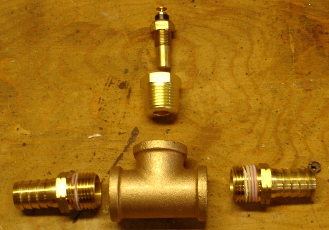

Here are the details of the sender unit. With an ipad this site only allows one picture to show in a post ?
