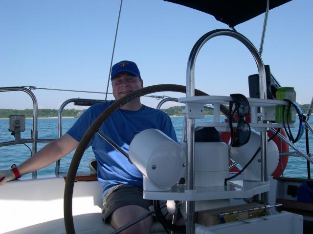

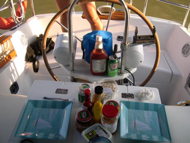

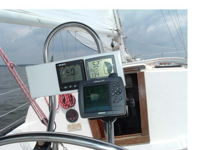

My pedestal guard has a garmin GPS mounted on the side. It also has the cockpit table attached to it ( a large folding starboard table ). My instruments are mounted on a pedestal frame in 2 pods which get in the way of using the throttle and gear shift. The pedestal, frame and guard combined make a very strong handhold in rough weather.
My plans are to replace those 2 instrument pods with a setup like Ed has, likely I'll also replace the GPS with a larger model.
Forgive the attached pictures, I wanted to show you other setups. It's Feb and I'm really missing those summer BBQs in the cockpit.
