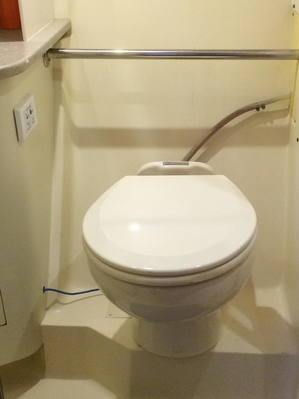

I have a Raritan Elegance on my 410 and love it. I have it connected to fresh water. The only issue is the door to the head barely closes with the seat down. I actually sanded a little bit of the seat so the door would close. If I would have thought about it before I installed it I could have moved it about and inch closer to the sink and avoided the problem.

I assume you placed it in the aft head? would it be possible to send a picture of the install? I would appreciate the pic. I am looking to install a new head in the fwd cabin. plenty of room up there for anything. Installed now is a standard jabsco manual head.
thank you
jd
You can see I obtained water for the head from the shower line. Power went into the vanity then up behind the vanity to the panel. I also put a thin piece of metal under the toilet to cover the existing hole under the bowl. If you look closely you can see a little of the seat is sanded away.
I kept the maual seawater toilet in the forward head and only use it if we are going to the Bahamas where water is limited. I may switch it out someday with an electric but would keep the seawater connection.
I also provided a pic of the shower door I made. Much better than the curtain. PM me if you have any further questions or interested in some of my other mods.

I can't recommend anything that you've done to install that toilet. Connecting the shower hose to the toilet bowl is no different from connecting any other fresh water line to the toilet...something that should never be done to any toilet designed to use sea water because it risks contaminating the fresh water supply, damage to the toilet, or both...and every toilet mfr warns against it in their installation instructions. This story illustrates good reasons why: http://www.chron.com/houston/article/Worms-infest-Houston-suburb-water-supply-6415176.php If it can happen to a municipal water supply, your onboard water supply is even more vulnerable.
"Power went into the vanity then up behind the vanity to the panel" doesn't sound like the toilet is on its own separate dedicated circuit, with its own breaker, shared by nothing else that either reduce power to the toilet or have power reduced to it if both are on at the same time because low voltage is very damaging to motors--including toilet motors-- and other electrical devices.
I've been at this enough years to be pretty sure you're just gonna let my comments go in one ear and out the other...but with any luck I can head off others who might think it's a good idea.
Why do you balk with such self proclaimed authority without really knowing more details? Your analysis of my installation is compeltely full of you know what. If anyone is interested in knowing exactly what I did you can pm me. I am tired of Peggy's get on her high horse thinking she knows everything.
