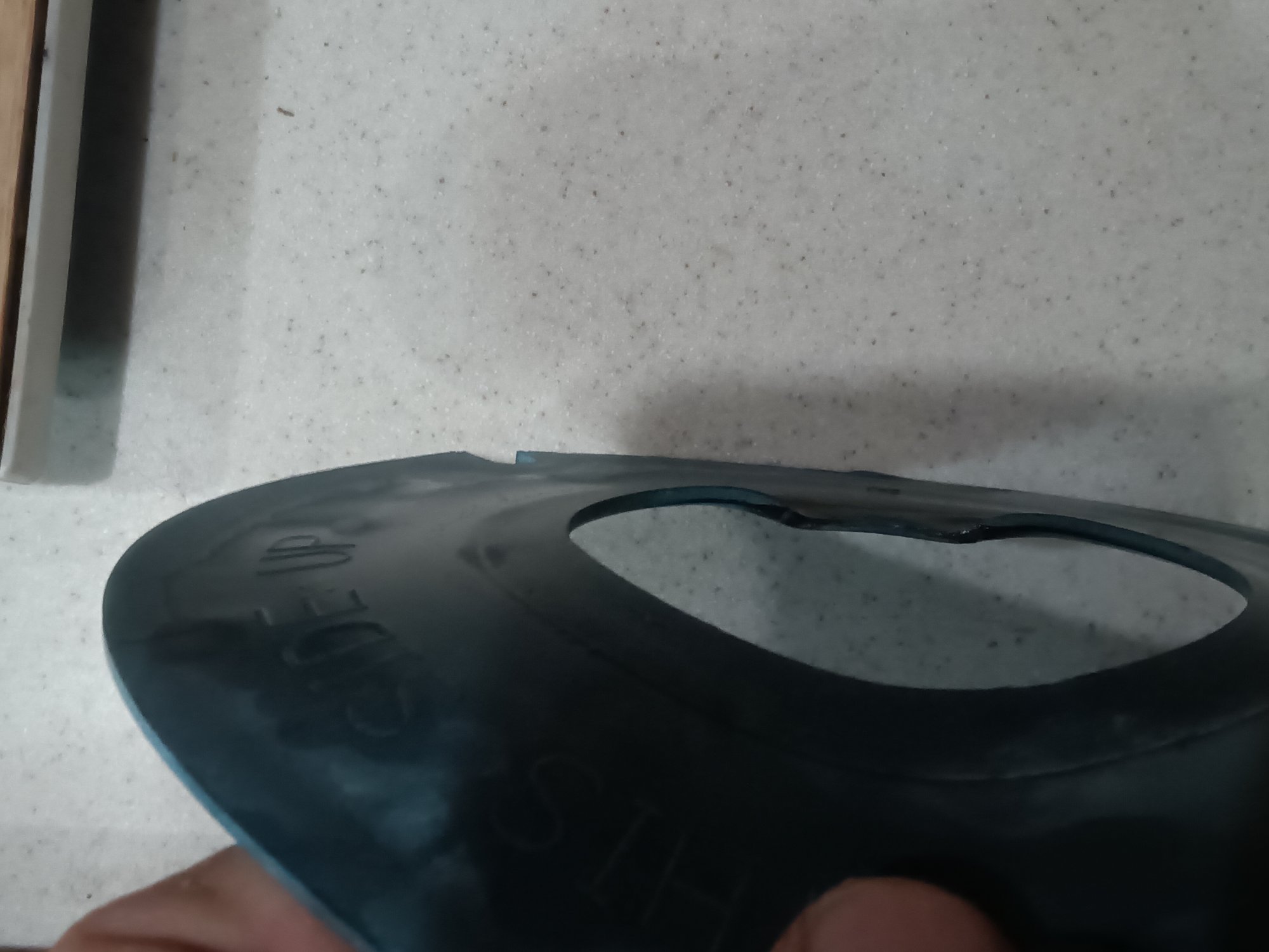

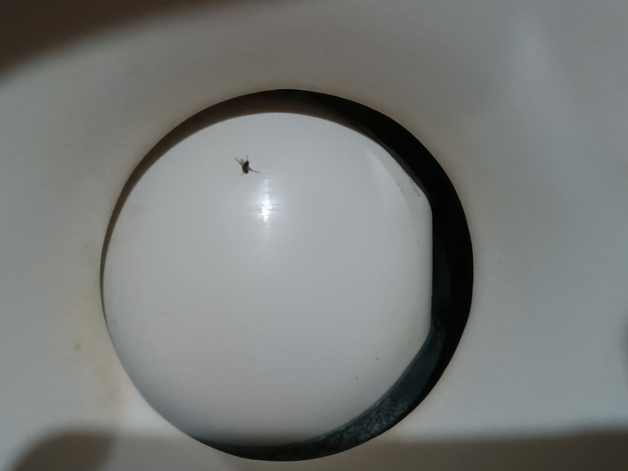

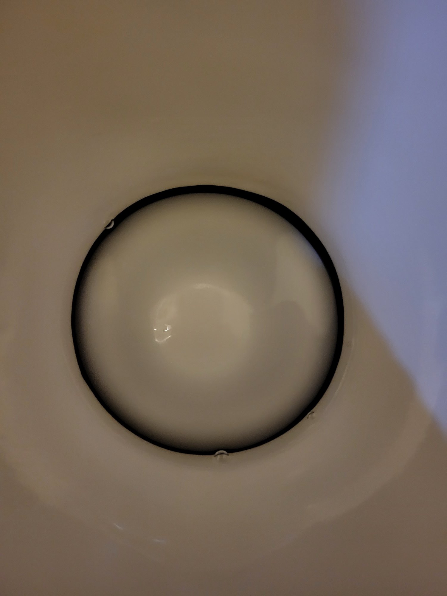

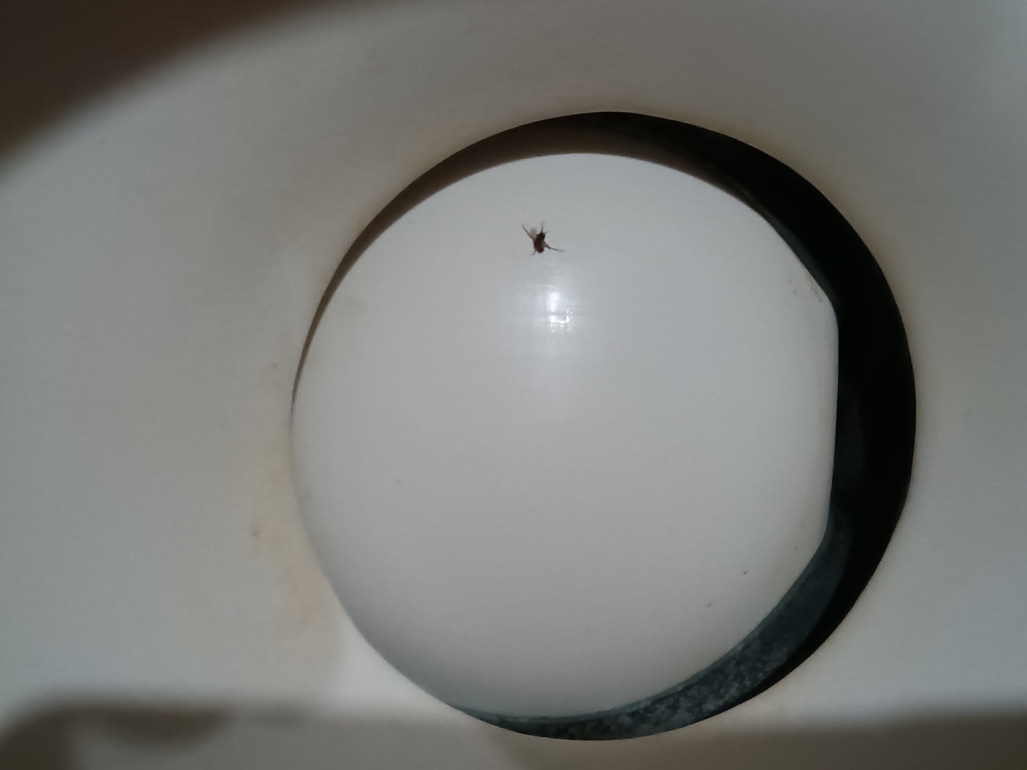

Here's a couple of pics I took prior..you can see the void in front of the ball between the puckered seal

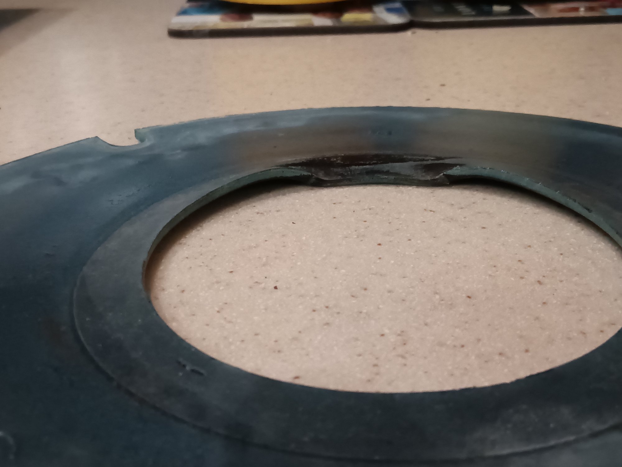

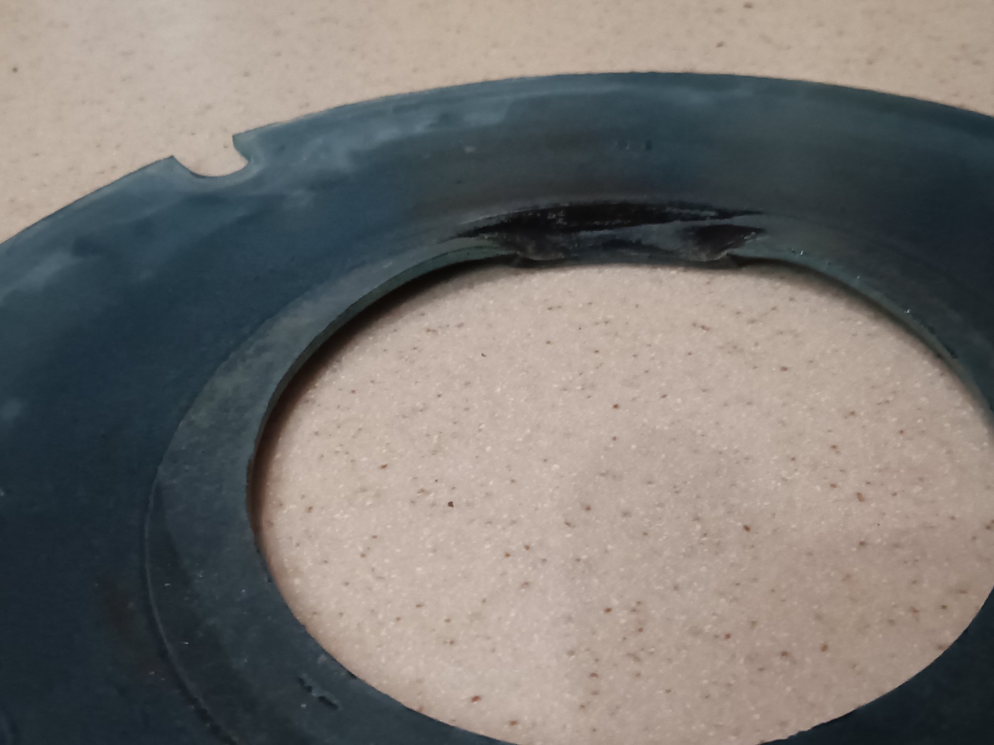

Another set of pics..just removed the Teflon seal..this has happened before..over the past few years...just wondering...I examine the ball it looks good no nicks or calcium build up . Spring feels pretty good..so I've never determined what causes this but these seals are ridiculous now
Feb 6, 2010
154
hunter passage456 kemah
That still can indicate a defective Teflon "plate" 'cuz it shouldn't be happening. So I'd get the phone # for the nearest VF service center and call them to ask why it's happening. Be sure to tell them this wasn't your "first rodeo" replacing bowl seals.
--Peggie
Wondering what's causing that depression..one possibility is the edge of the ball is overriding the seal on the return and push it down under or it's not returning forward enough and the vacum is sucking the unsupported section that the ball has left down...until it loses the ability to come back...if so what's causing either of those failures..or is it something else Altogether. I've gotten a whole year on a seal in the past..I've used at least 3 maybe 4 since last summer
Aug 18, 2018
146
Hunter 410 MDR
Somethings not right with the install. It doesn't look right, looking down on my flush ball the gasket is barely visible, the ball is centered.
It's been a while but I remember the linkage, install of the ball was a little tricky while the 2 sealing gaskets were pretty straightforward and marked.
Are you positive everything is seated correctly as it looks like the gasket gets damaged after the installation.
