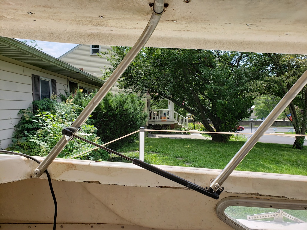

I saw all the posts about the gas strut mod for the pop top. Went on Amazon, bought some brackets and a pair of 20" 80-lb lift gas springs. After drilling a few holes in the wrong place, I'm stumped-where can you actually locate the springs so that they can open fully, and still let the pop top close without getting in the way? I've seen information for other models, but it looks like their pop tops open in the opposite direction. Does anyone have specifics for a 222?
