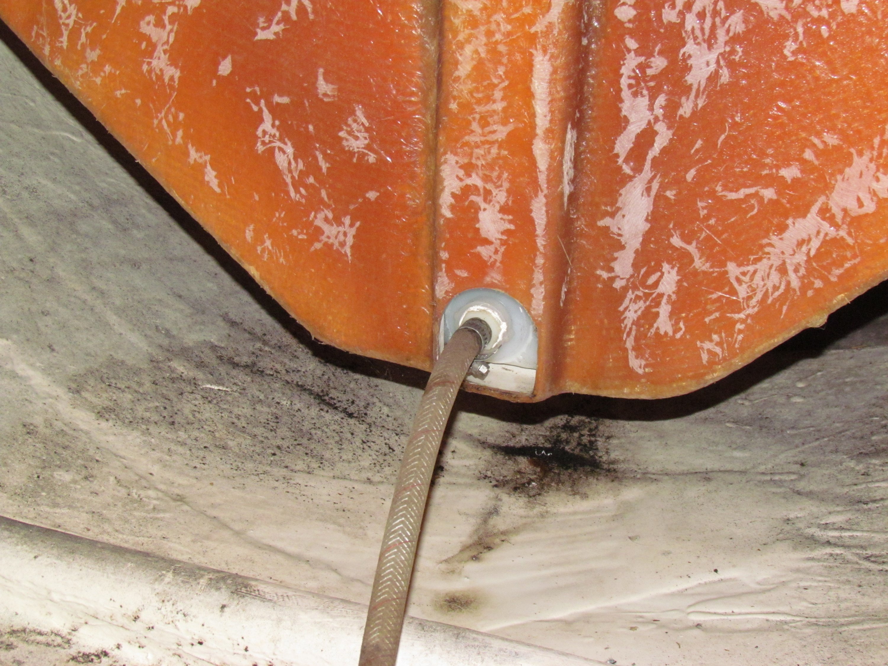

Here is what the tank looks like. You can't really see the connection in the tank.
But is your tank empty or is there just water in the bilge?
Bilge had been vacuumed to dry ( from previous rain) .

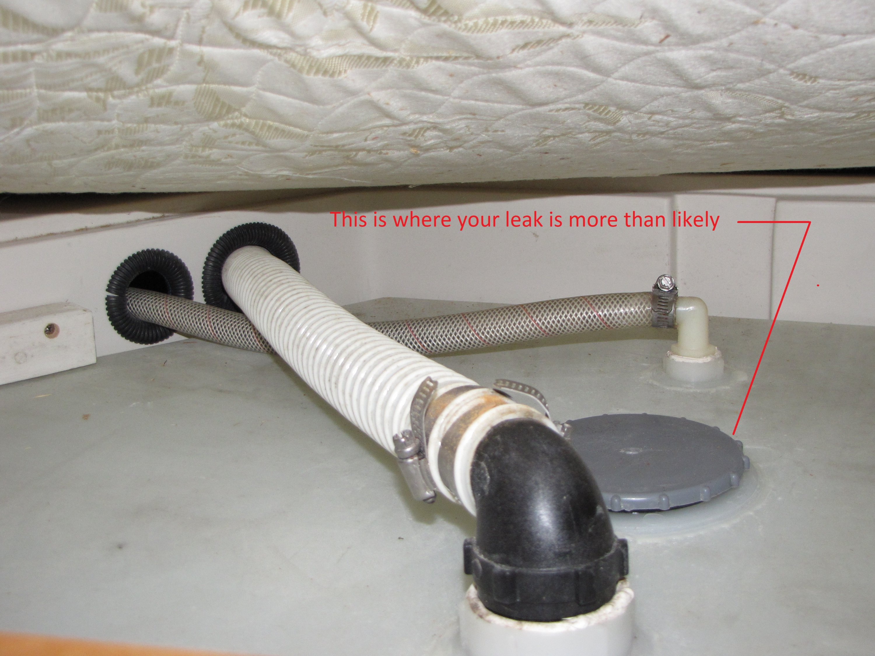

Fill your tank up until water comes out of the fill hole on deck.
Then lift up v berth matress, remove board and check around big black inspection cap.
This is where you will find water leak :dancing:

Clyde,
Was the tank empty or just water in the bilge?
If the tank was full and there was water in the bilge, look at what Paul said. Many fill the tank until water flows out the fill. There are several places you could leak that would fill the bilge while still filling the tank. The clean out, the fill connection, the vent connection, etc.
If the tank is empty that's another story.
paulj
:hook2:
Been there. Done that. Pumped out the bilge after...

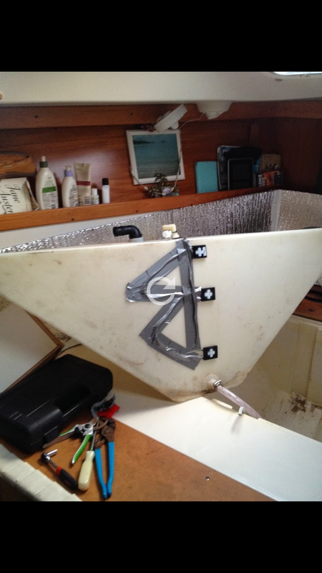

If I'm starting with an empty tank I put a flow meter on the end of the hose and stop at 34-35 gallons. Eventually I'll put sensors on the tank (to match the ones on the waste tank), but that's a major project to get at the side of the tank and run the wires.
Jesse, is that duct tape holding down your sensors and wiring? Has it worked well? Need to do it on our boat soon.
Yes. The sensors are the square pieces. The tape was just to hold the wire for putting the tank back.
It works great. It just says if the tank is empty, 1/3 full, 2/3 full and full. I put the sensors a little far apart. So the readings aren't perfect but it really helps. We have since calibrated it and know its 10 gallons from full to 2/3s, 15 gallons from 2/3 to 1/3 and 10 gallons from 1/3 to empty.
Nice. That's the same setup I'm doing. What did you use to glue the sensors on? The ones I used on the waste tank didn't seem to hold real well, but I haven't pulled the board off since I did it to see if they've fallen off. Sticking things to plastic is always a little dicey.
