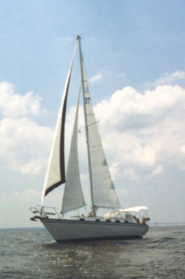

Rolled inside-out?
As someone stated the UV cover is sewn on just one side of the leech of the sail. If you furl the sail the wrong way the UV cover will be on the inside and offer no protection. But you should be able to unfurl a few feet of jib and see the cover, that 12" or 18" strip on the leech. In the attached picture the jib UV is on the port side. So the sail would have to be furled clockwise(looking down on the furling drum).
