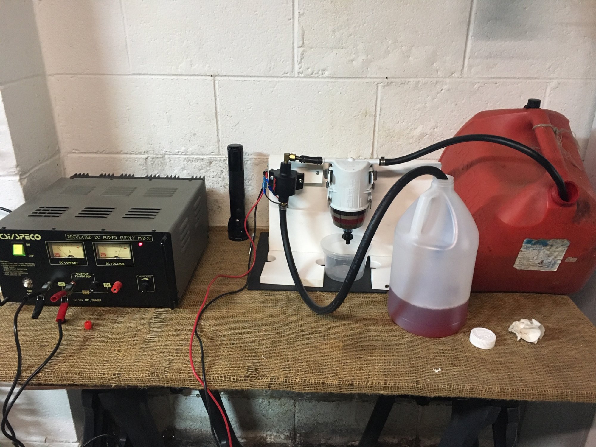

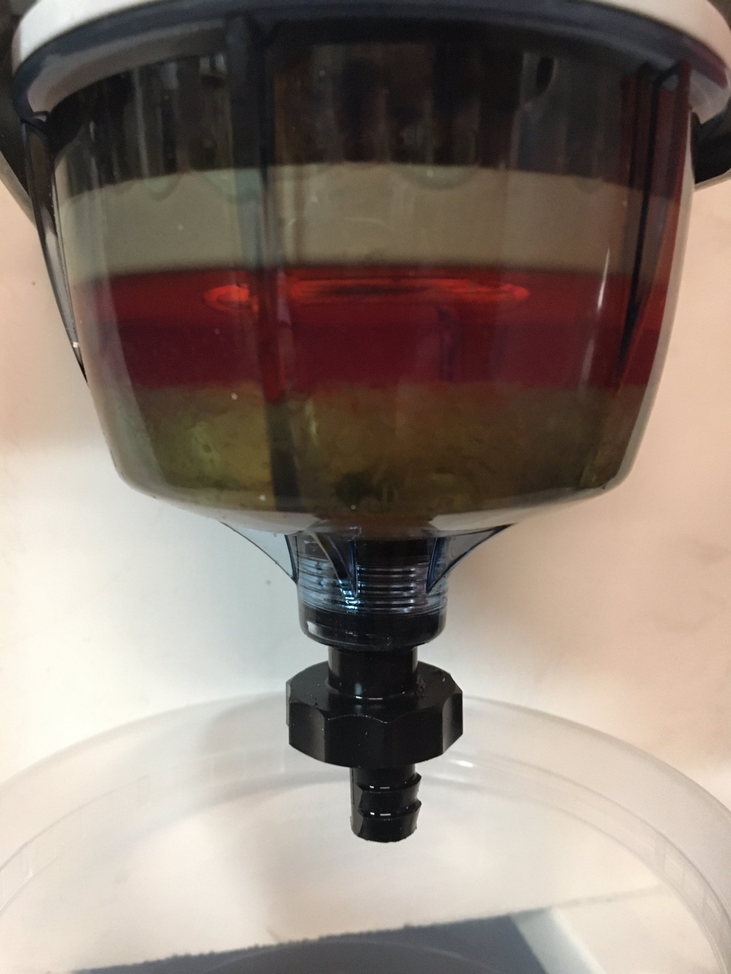

As I removed a perfectly good Racor Fuel/Water Separator Filter and replaced it with the two R12T units, I created my own fuel cleaning process. I've actually run 19 gallons of fuel through it, got a lot of crap and water separated. I finally found use for the old machine I've had stored in my workshop.
Oh and yes, I know I'm using the wrong tank for diesel, but its out of necessity. It's labeled as diesel on the other side. Once the fuel is back in the tank, the label will come off.

I made the same system with an old filter. Works great. You can also use it to pump out your tank to clean it by connecting to your batteries on the boat. I added a switch to the rig so I can turn it on and off easily. I also run all new fuel I buy in jugs through the filter to make sure it is clean going into the tank. Nice job Robert! I like your power supply, instead of using a battery in the garage that is a nice convenience.

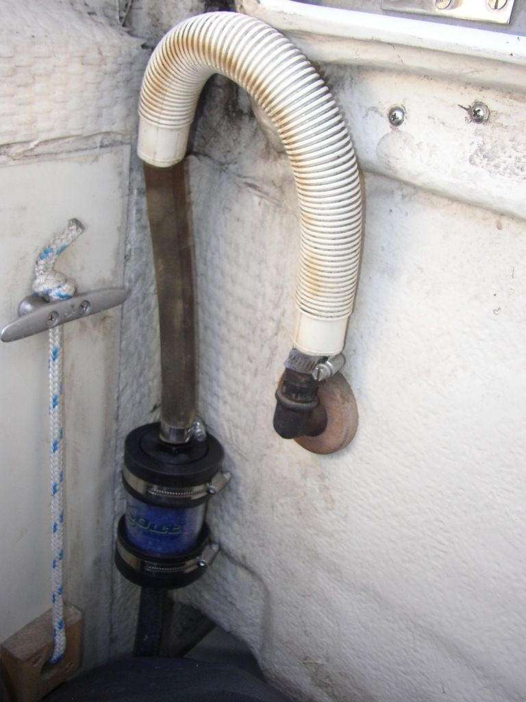

A tip I got from Practical Sailor was to add a fuel vent desiccant filter. I installed the recommended H2Out
