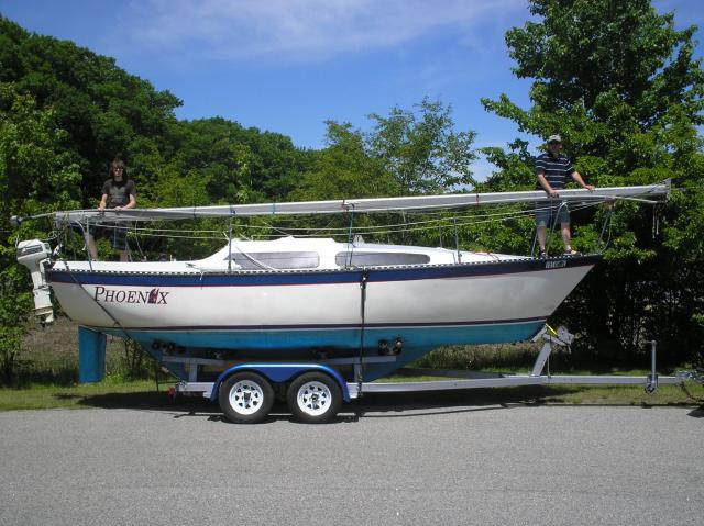

My Lancer 25 is about 4000 lbs with gear, draws about 30 inches, sleeps 5 (in a pinch) and we launch it every time. From the time we stop the truck to the time the boat is floating free is about 35 minutes, unless I strike up a sailing conversation with a passer by. It happens. We sail about 20 times per year. We have to step the mast, attach the roller furler, the boom, hank on the main,and run all the lines. But, after two years, we're getting pretty good at it. I'm 48 and in reasonable shape and my wife is in good shape. There Macs that are water ballasted, Seawards that draw 17 inches (board up) and all are trailerable.
Oh, and we make long weekends at the islands too. Keep heart! The right boat is out there for you!
Nov 9, 2008
1,338
Oh, should have mentioned:
2ND time launching was at a a rather shallow ramp on a large lake. There was a large band of twenty somethings in bathing suits the size of band-aids, a short distance away watching intently, waiting for the old guy to give up. The boat launched without a hitch, much to their chagrin. A shoal keel does have it's limitations but we have had it to 6 1/2 knots (hull speed) and in 30 knot winds (not at the same time!). Go shoal!
