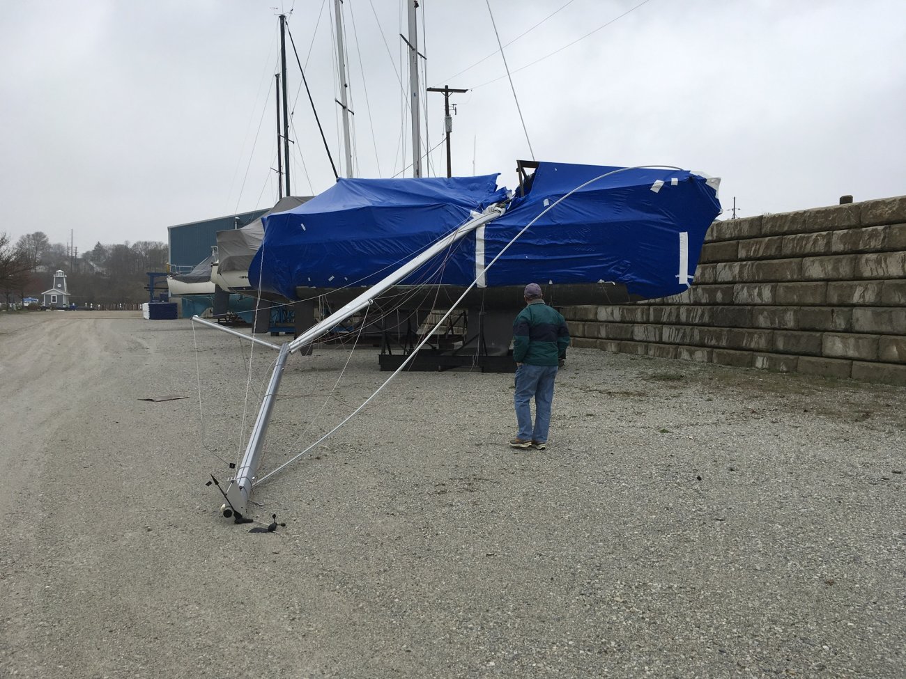

Hey Ron, my mast is newer than yours due to that winter dismasting two years ago.
