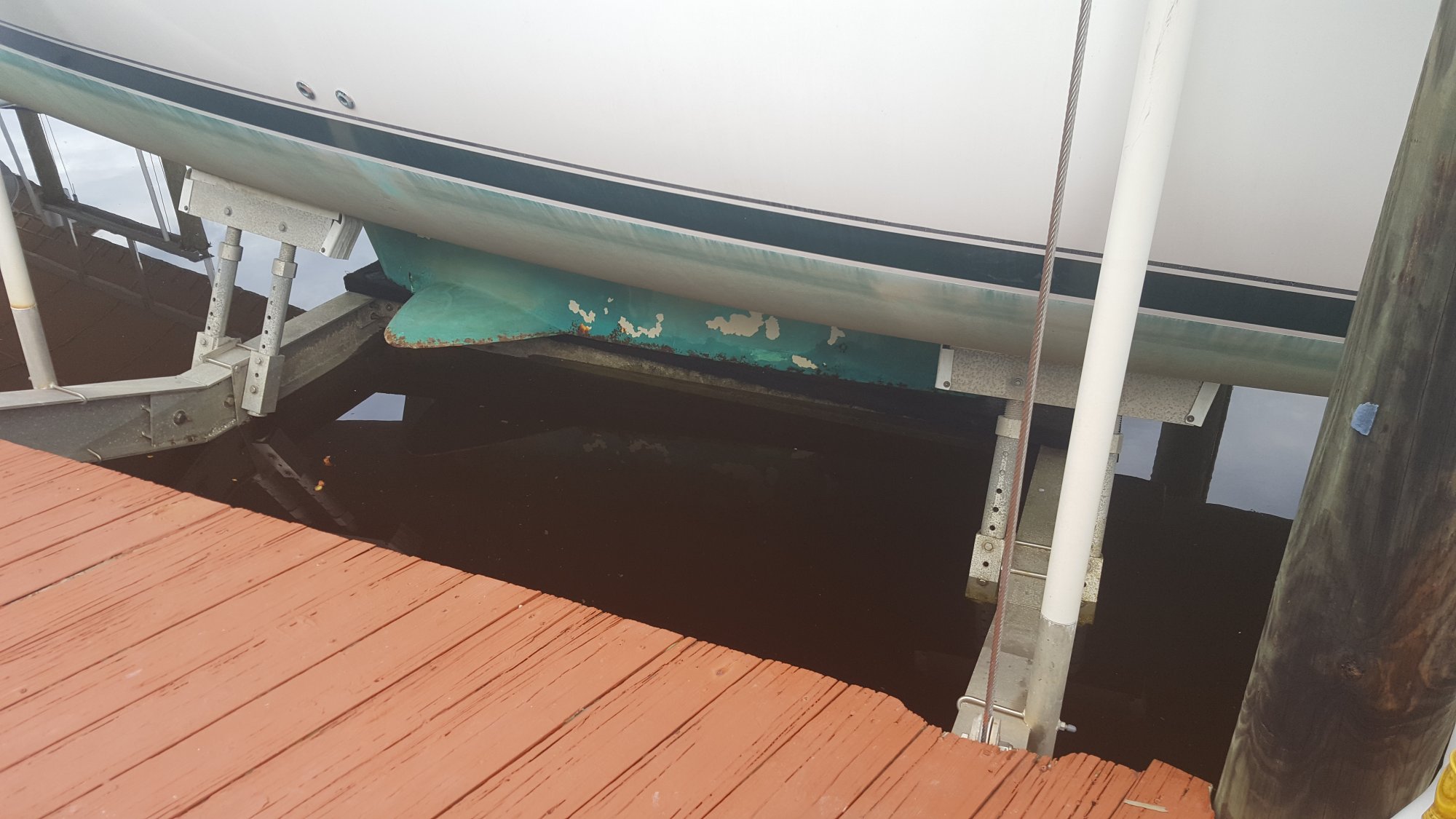

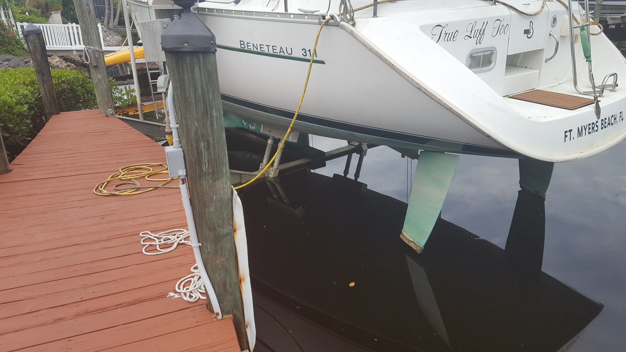

All of the sailboat on lifts that I have seen around here have a central beam on which the keel sits and props to "balance the boat" I have kept/ keep two sailboats on a lift both were/are wing keels not sure how it would be in the case of fin keel. I would be happy to post a picture of my Beneteau on the lift if you would like to see.

Beneteau 311 Ft Myers Beach
Here's a couple of pictures I just took with my phone. Yeah I know I need bottom paint, I'm waiting till August when sailing is unbearable around here
Thanks for the pictures and the advice about the bottom paint.
