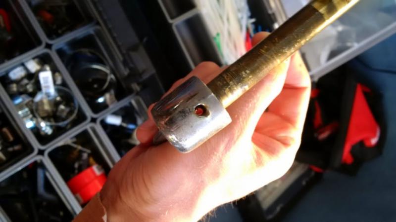

The shifter on my gear pedestal is held on by a screw - this had already given way once (and was the first repair I did) and it gave way again when I was on a docking lesson - luckily in the middle of the channel, rather than the crowed marina. It would have been a Bad Time if it had happened a minute sooner or later, so I decided to do a modification.
First, using a carbide drill bit, I drilled all the way through the stainless handle and brass rod.

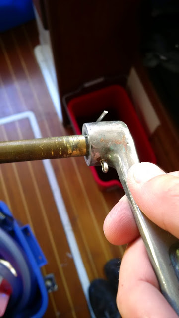

Then I inserted a pin in there and bent the edges round.
Even if it DOES break (which I don't think it will), its a matter of seconds to swap out the pins, since I'm going to tape a spare one to the pedestal.
