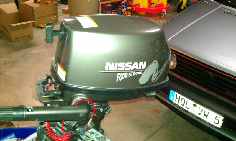

We just bought a 2002 Nissan 6hp for-stroke long shaft in like new condition for $450. He was asking $600 in the add on craigs list. The guy said there is only probably 10 hours on it. It was his kicker motor on his fishing boat. I looks like a new one. I ordered the high thrust "elephant ear" prop for it a couple of days ago. The deals are out there..get a four stroke. I checked craigs list every morning for three weeks..most people are negotiable. I just asked the guy "if he would consider taking any less?" $450 was a deal. The mercury, nissan and tohatsu four strokes are all identical "made by tohatsu" 30 hp and under. Mine sounds like a sewing machine when idleing. We love ours.

BTW Our motor weighs 59lbs. Not bad for a four-stroke. we are going with the HT prop because our came equiped with high speed prop.

The same one we bought used for $600, I'm not a good negotiator :neutral:, in fact I didn't even try. Ours is the 5 HP, just a different carb and you can make the 4 HP or 5 HP a 6 HP with about $140 carb change. I didn't feel it was worth the effort since we never ran it wide open when we did have it on the Mac the one time.
I did change the prop from the 8 pitch that was on it to a 6 pitch. With the 8 pitch it would just barely get the inflatable on plane with only one person in it. Since that wasn't usually the case and since we wanted it as a backup for the Mac outboard we changed to the 6 and kept the 8 as a spare.
At the time I didn't know about the 'sailPro' model and if I'd had know that I would of gotten the larger dia. 6 pitch they sell for that model. If you were running the 4,5 or 6 HP full time on a sailboat I'd get that prop (Tohatsu Part Number 399B645121)....
http://www.tohatsuoutboardparts.com/Props-and-Hardware.html
Those Nissan/Tohatsu/Merc 4,5,6 HP are a great motors an aren't like you said aren't that heavy. We also really like the 3.5 HP that we now have for the inflatable. Also starts and runs great,
